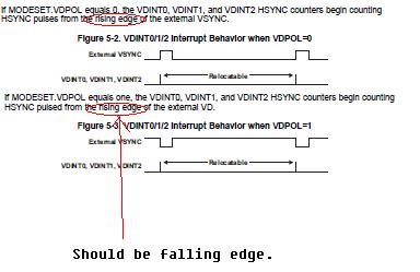

My customer found below bug in DM36x VPFE guide. Would you pls help to double comfirm and correct it?
