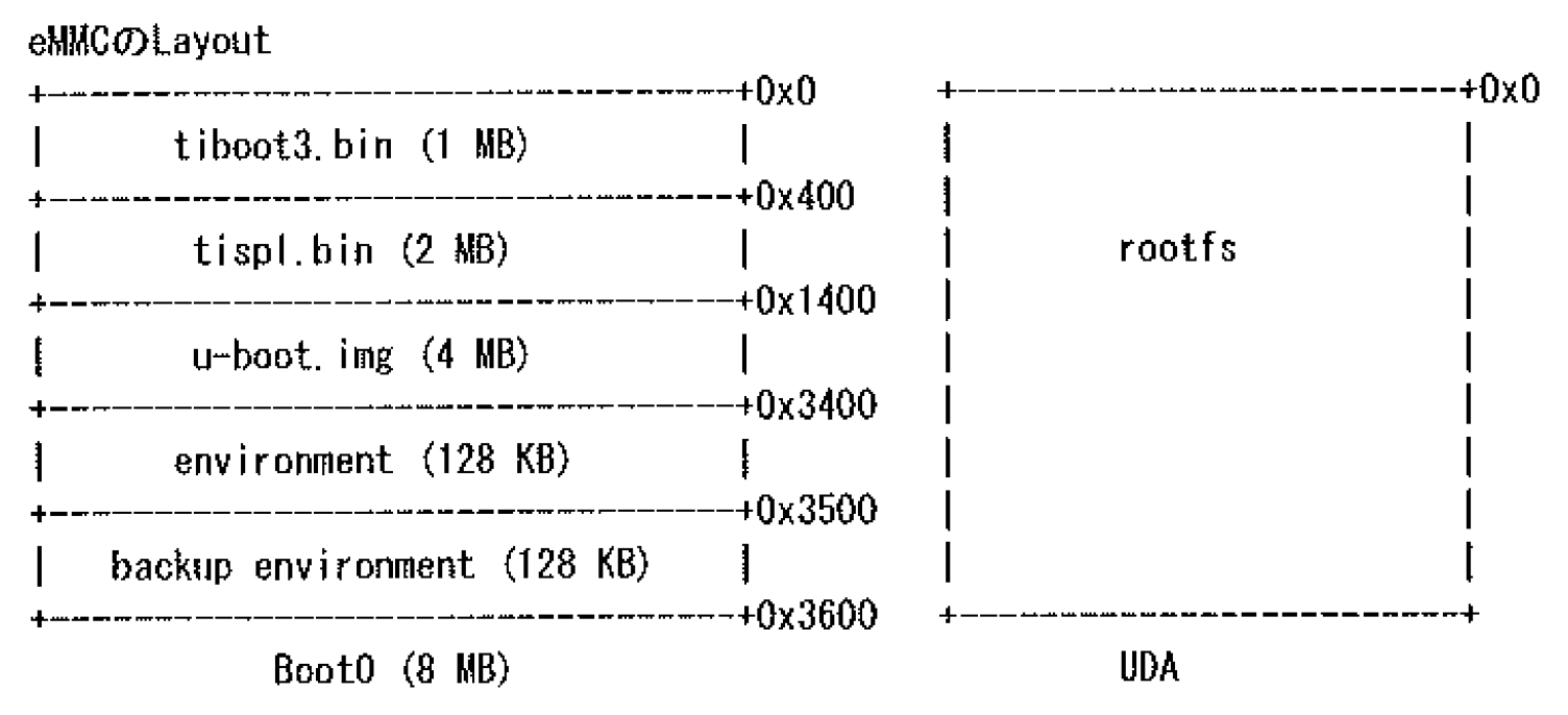

When booting with eMMC,
can it operate by specifying file like microCD?
The first 8MB of eMMC is designated as the boot area.
From the top of the eMMC,
tiboot3.bin at 0x0000,
tispl.bin at 0x0400,
and u-boot.img at 0x1400.
Is this location fixed in the AM62 eMMC boot?
Can you store this as a file in the USER area (FAT area) and operate it?
FAT area of eMMC.
