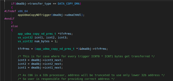

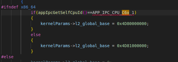

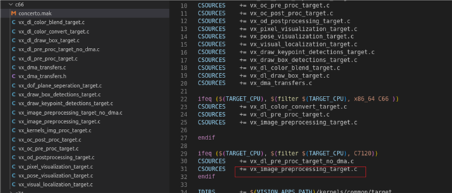

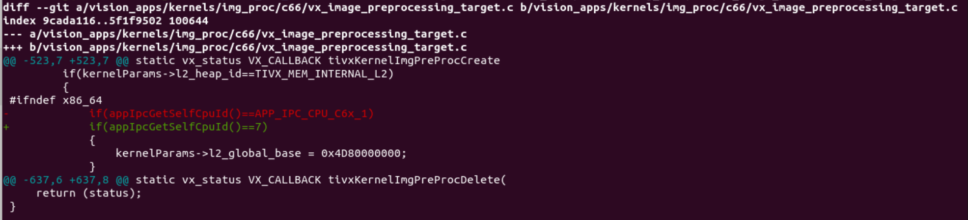

In the TDA4VH 11.00 SDK,  we observe that in the makefile file, when the image_preprocess node is running on C7X, the default compiled file is vx_image_preprocessing_target_no_dma.c.
We attempted to forcibly modify the makefile file, but the time consumed by image_preprocess was reduced, but the output result was incorrect. As shown in the figure below:
The output image is as follows:
