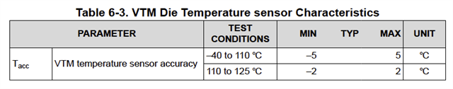

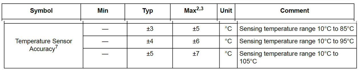

Customer thermal team would like to learn the accuracy of the temperature sensor inside DRA821 like below.
Do we have similar information?

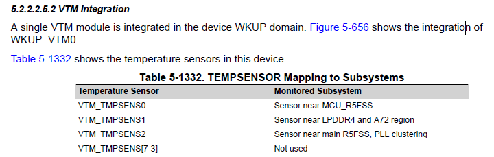

What's the definition for temperature grade 105 degree C? Does it mean all three temperature sensor can sustain over 105 degree C?
Or specific one temperature sensor is the standard we use for 105 degree?
