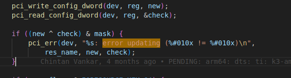

    However, we can see an error in the previous capture I gave you.
    [    0.646188] pci 0000:01:00.0: BAR 0: assigned [io  0x8000-0xffff]
    [    0.646235] pci 0000:01:00.0: BAR 0: error updating (0x10009001 != 0x10008001)
    The BAR has been assigned but it looks that the BAR is not usable.
    Can you help us about that?

  • Hi K.Luong,
    It looks like the config register of the PCIE device could not be written to:
    Takuma

  • Hi K.Luong,
    We do not test specifically for IO BAR functionality. On the FPGA-side, is the PCIe configuration register for setting BAR0, and that particular bit that is not changing, writable?
