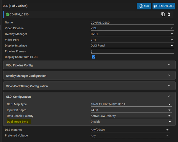

    The project from A53 I am working on enabling does not interface with SysConfig. Do you mind sharing how you set SysConfig for both single and dual link?

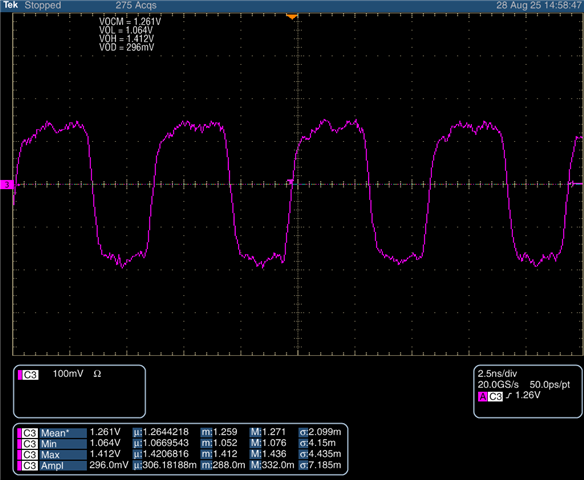

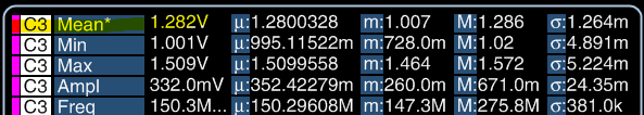

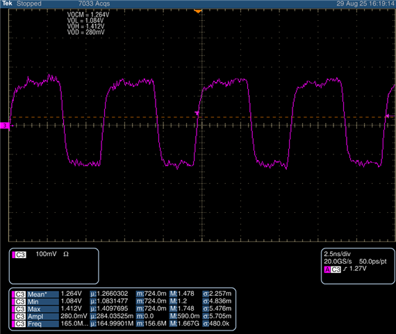

    In the meantime, we also tested it on the TI evaluation board and we have the same behavior. The measurements were made both with and without the display, and the change we see is that of the amplitude of the signal due to the presence of the termination resistance that is present on the panel. The behaiviour is the Same for data and Clock. We also note that on the D3 data line the common mode is at about 200 mV. but when it is reconfigured to dual link, the VOCM returns to 1.2V
    Below you will find the acquisitions of our board and those made on the evaluation board:
    Measurements on our electronic board:
    Single link:
        D0 without TFT
         D0 with TFT
    Dual link:
       D0 without TFT
    D0 with TFT
    Measurement on the TI Evaluation Board
    Single Link
    D0 without TFT
    Dual link:
    D0 without TFT
    In the Figure below you can find the acquistion on D3 on the TFT and our Board

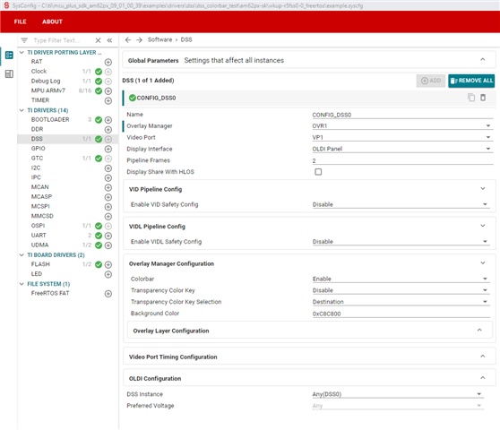

    On Sysoconfig the setting are as in the figure below and when dual mode sync is selected the configuartion changes to Dual Link 24 bit automaticaly.
