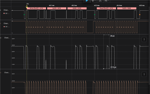

We are integrating the OV2311 image sensor camera( https://www.e-consystems.com/raspberry-pi-4/ov2311-mipi-2mp-monochrome-global-shutter-camera-module.asp  ) module on CSI-2 interface and I²C in a Linux kernel driver. The sensor is detected at its expected i2c address. However, when attempting to read the Chip ID register (0x300A) or any register, we consistently receive 0x00.
We have verified the following:
  • The I²C bus is functional, and other devices respond correctly.
  • The sensor acknowledges its address.
  • Writing a register address followed by a read operation still returns 0x00.
The logic analyzer trace confirms the transactions are occurring.
Our reference driver is the TI OV2312 driver.
We need guidance on whether any hardware modifications are required to ensure proper communication between I²C and SCCB on the SK‑AM62‑LP — for example, removing or adjusting I²C pull‑ups.
Please suggest possible causes and recommended solutions.

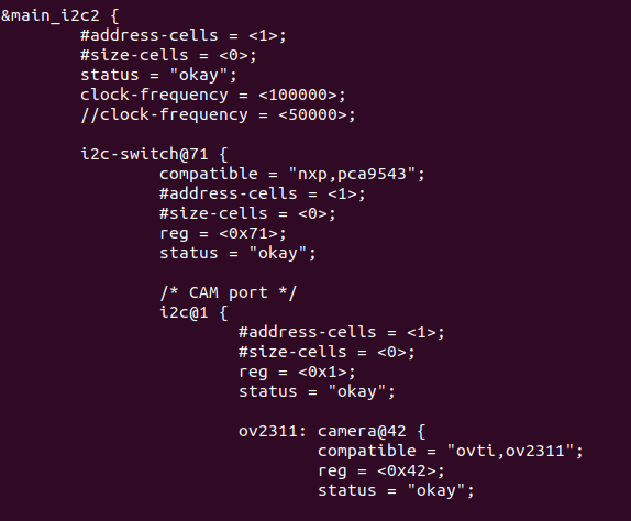

  • Hi Jianzhong,
    We have cross-verified the pin mappings with the DTS, and everything appears to be correct according to me. The i2c clocks and data signals are visible on the oscilloscope on the same pins.
    Please find attached the connection details of the camera and SK-AM62-LP, along with the logs.
    SK-AM62-LP and camera Connections
    ov2311_dmesg_i2cdump_logs_30
    Gopal Sharma

  • Hi Jianzhong,
    Yes, this is expected. I²C2 is the master bus where the PCA9543 switch (0x71) is connected. The OV2311 camera is connected to channel 1 of the switch, which the kernel exposes as I²C bus 4.
    So while the physical connection is via I²C2, the camera (0x42) appears on I²C4 due to the switch’s dynamic bus mapping. All interactions with the OV2311 should happen through I²C4.
    Our observation is based on the logs below. Could you please verify if we're missing anything

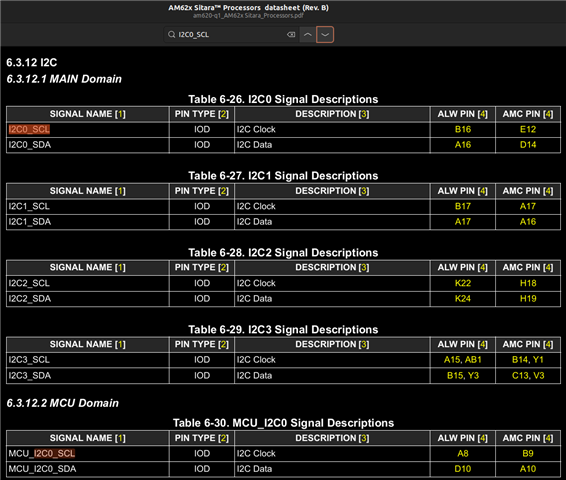

    According to the datasheet there are only 4 i2c interfaces available for MPU and 1 For the MCU.
    Gopal
  • Hi Gopal,
    I double checked the schematic of SK-AM62-LP and believe your device tree is correct:
    Let me loop in my colleague for some help.

    Can you provide some advice on how to debug the I2C?
    Jianzhong
  • Hello Jianzhong,
    The i2cdetect output of UU tells us that a driver is currently using the device at address 0x42. Thus, i2cdump will fail to interact with the device at 0x42 (because Linux will not let i2cdump interfere with whatever the Linux driver is doing on 0x42).
    Hello Gopal,
    1) Where did you capture the waveform? Between the AM62x & the switch? Between the switch and the OV2311? Please verify that you see the same signals on both sides (e.g., make sure that the ACK signal is actually coming from the OV2311, not getting added in by the switch)
    2) The waveform you captured showed a read command returning all zeros. Please share the waveform from before that read, showing a successful write interaction with OV2311.
    The rise/fall timing for the ACK might be too close to the rising edge of the clock - hard to tell from looking at your waveform. But the AM62x seems to respond just fine in the waveform you shared, so let's ignore this for now.
    3) I am having trouble finding a datasheet for the camera showing what kind of I2C frequency it is designed to interact with. Can you confirm this device was designed to work with 100kHz?
    Nick
  • Hi Nick and Jianzhong,
    Thank you for your support.
    Due to the lack of detailed information about the camera module hardware, we are facing some issues. After further hardware analysis, we realized there is another hardware layer between the image sensor and our driver. We are currently working on finding a method to interact with the image sensor and will get back to you soon.
    1. Where did you capture the waveform?
      Between the switch and the OV2311.
    2. I am having trouble finding a datasheet for the camera showing what kind of I2C frequency it is designed to interact with.
      The device is designed to work up to 400 kHz. We are trying it with a lower frequency.
    Is it possible to debug a Linux driver using breakpoints? If so, please kindly share the method.
    Currently, we are using Vim for driver development. If there is any preferred and more productive tool, please suggest.
    Gopal Sharma

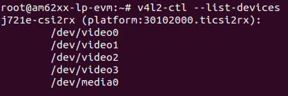

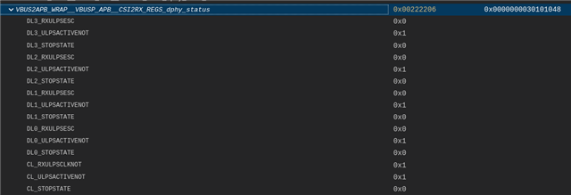

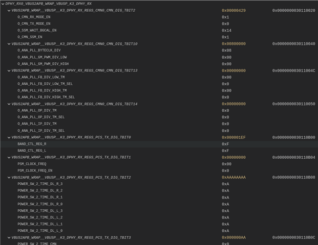

  • Hi Team,
    We tried the following command, but no frames were received. Although the stream started and continued until manually stopped, the out_grey.raw file remained 0 bytes.
    root@am62xx-lp-evm:~# v4l2-ctl -d /dev/video0 --stream-mmap --stream-count=30 --stream-to=out_grey.raw
    [ 2169.115258] ov2311_cam21_econ 4-0042:  mcu_cam_stream_on 1775 mcu cam stream on attempt
    [ 2169.175284] ov2311_cam21_econ 4-0042: mcu get cmd status successfully
    [ 2169.181836] ov2311_cam21_econ 4-0042:  mcu_cam_stream_on 1819 MCU Stream On Success !!
    We also attempted several other commands to configure the pipeline, but without success. For reference, I have attached the command logs and dmesg logs.
    Command and Dmesg Logs:-

    Then we configure the sensor and media to match the required format, and it starts, but we don’t see the
    <<<<<<<<<<<<<<<<<<<<<<<<<<<<<<<<<<< 33.75 fps.
    The detailed commands and logs are as follows:
    root@am62xx-lp-evm:~# media-ctl -d /dev/media0 -V "'cdns_csi2rx.30101000.csi-bridge':0 [fmt:Y8_1X8/1600x1300]"
    root@am62xx-lp-evm:~# media-ctl -d /dev/media0 -V "'cdns_csi2rx.30101000.csi-bridge':1 [fmt:Y8_1X8/1600x1300]"
    root@am62xx-lp-evm:~# v4l2-ctl -d /dev/video0 --set-fmt-video=width=1600,height=1300,pixelformat=GREY

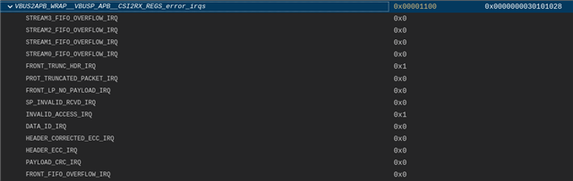

    We also checked the waveform on the DSO and confirmed that data is present on the camera lane. However, we are not sure if the data is valid.
    Gopal Sharma
    Thanks for the detailed logs. Everything looks good on the SoC's CSI Rx side, the only thing that I can think of is either the sensor is not sending data properly, or the HW connection is having some issues. Can you check a few registers and see if the CSI Rx is receiving data, or if there are any errors?
    Jianzhong
  • Hi Jianzhong,
    Thank you for support.
    I think we need the live status of these registers during streaming.
    Could you please share the method to read or print the live status of these registers from the kernel?
    Gopal Sharma
  • Hi Gopal,
    You can use devmem2 command to read the registers. For example, to read error_irqs, you can do:

  • Hi Jianzhong,
    With the suggested method, we are still not able to fetch the register value.
    root@am62xx-lp-evm:~# devmem2 0x30101028
    /dev/mem opened.
    [  495.513745] kauditd_printk_skb: 7 callbacks suppressed
    Memory mapped at address 0xffffb5062000.
    [  495.513767] audit: type=1701 audit(1756372941.641:22): auid=4294967295 uid=0 gid=0 ses=4294967295 subj=kernel pid=2112 comm="devmem2" exe="/usr/bin/devmem2" sig=7 res=1
    [  495.558811] audit: type=1334 audit(1756372941.685:23): prog-id=21 op=LOAD
    [  495.565719] audit: type=1334 audit(1756372941.693:24): prog-id=22 op=LOAD
    [  495.572615] audit: type=1334 audit(1756372941.701:25): prog-id=23 op=LOAD
    Bus error (core dumped)
    root@am62xx-lp-evm:~# [  495.920308] audit: type=1334 audit(1756372942.049:26): prog-id=23 op=UNLOAD
    [  495.927356] audit: type=1334 audit(1756372942.049:27): prog-id=22 op=UNLOAD
    [  495.934385] audit: type=1334 audit(1756372942.049:28): prog-id=21 op=UNLOAD
    root@am62xx-lp-evm:~# devmem2 0x30101048
    /dev/mem opened.[  508.592993] audit: type=1701 audit(1756372954.721:29): auid=4294967295 uid=0 gid=0 ses=4294967295 subj=kernel pid=2147 comm="devmem2" exe="/usr/bin/devmem2" sig=7 res=1
    Memory mapped at address 0xffffaa4b7000.
    [  508.625676] audit: type=1334 audit(1756372954.753:30): prog-id=24 op=LOAD
    [  508.632575] audit: type=1334 audit(1756372954.761:31): prog-id=25 op=LOAD
    [  508.639494] audit: type=1334 audit(1756372954.765:32): prog-id=26 op=LOAD
    root@am62xx-lp-evm:~# [  508.976353] audit: type=1334 audit(1756372955.105:33): prog-id=26 op=UNLOAD
    [  508.983413] audit: type=1334 audit(1756372955.105:34): prog-id=25 op=UNLOAD
    [  508.990417] audit: type=1334 audit(1756372955.105:35): prog-id=24 op=UNLOAD
    root@am62xx-lp-evm:~# devmem2 0x3010104c
    /dev/mem opened.[  518.813060] audit: type=1701 audit(1756372964.941:36): auid=4294967295 uid=0 gid=0 ses=4294967295 subj=kernel pid=2175 comm="devmem2" exe="/usr/bin/devmem2" sig=7 res=1
    Memory mapped at address 0xffffb7e69000.
    [  518.846357] audit: type=1334 audit(1756372964.973:37): prog-id=27 op=LOAD
    [  518.853613] audit: type=1334 audit(1756372964.981:38): prog-id=28 op=LOAD
    [  518.860667] audit: type=1334 audit(1756372964.981:39): prog-id=29 op=LOAD
    root@am62xx-lp-evm:~# [  519.180322] audit: type=1334 audit(1756372965.309:40): prog-id=29 op=UNLOAD
    [  519.187377] audit: type=1334 audit(1756372965.309:41): prog-id=28 op=UNLOAD
    [  519.194423] audit: type=1334 audit(1756372965.309:42): prog-id=27 op=UNLOAD
    root@am62xx-lp-evm:~# devmem2 0x30101004
    /dev/mem opened.[  527.948977] audit: type=1701 audit(1756372974.077:43): auid=4294967295 uid=0 gid=0 ses=4294967295 subj=kernel pid=2202 comm="devmem2" exe="/usr/bin/devmem2" sig=7 res=1
    Memory mapped at address 0xffffbbeb8000.
    [  527.981667] audit: type=1334 audit(1756372974.109:44): prog-id=30 op=LOAD
    [  527.988575] audit: type=1334 audit(1756372974.117:45): prog-id=31 op=LOAD
    [  527.995440] audit: type=1334 audit(1756372974.121:46): prog-id=32 op=LOAD
    root@am62xx-lp-evm:~# [  528.316263] audit: type=1334 audit(1756372974.445:47): prog-id=32 op=UNLOAD
    [  528.323298] audit: type=1334 audit(1756372974.445:48): prog-id=31 op=UNLOAD
    [  528.330307] audit: type=1334 audit(1756372974.445:49): prog-id=30 op=UNLOAD

    I would like to inform you that we observed data on the lane using a oscilloscope. In the normal case, it gets stuck after starting a stream on when i begin capturing frames. However, when we stop the data on the lane by making some code changes, the behavior changes — the driver starts and stops streaming randomly when I begin capturing frames.
    This camera reference driver is based on the Raspberry Pi implementation. I have also attached the dmesg log from the Raspberry Pi, which may be helpful.

    The fact that this command doesn't work on your setup tells that your system may have some problems.
    Jianzhong
  • Hi Jianzhong,
    These registers may be mapped by the driver, such as cadns-csi2rx, and attempting to read them at runtime shows an error. Other registers can be read successfully with devmem2.
    Register mapping in driver
    #define CSI2RX_ERROR_IRQS_REG                   0x28
    #define CSI2RX_ERROR_IRQS_MASK_REG              0x2C
    static irqreturn_t csi2rx_irq_handler(int irq, void *dev_id)
            struct csi2rx_priv *csi2rx = dev_id;
            int i;
            u32 error_status;
            error_status = readl(csi2rx->base + CSI2RX_ERROR_IRQS_REG);
            for (i = 0; i < CSI2RX_NUM_EVENTS; i++)
                    if (error_status & csi2rx_events[i].mask)
                            csi2rx->events[i]++;
            writel(error_status, csi2rx->base + CSI2RX_ERROR_IRQS_REG);
            return IRQ_HANDLED;
    static const struct csi2rx_event csi2rx_events[] = {
            { CSI2RX_STREAM3_FIFO_OVERFLOW_IRQ, "Overflow of the Stream 3 FIFO detected" },
            { CSI2RX_STREAM2_FIFO_OVERFLOW_IRQ, "Overflow of the Stream 2 FIFO detected" },
            { CSI2RX_STREAM1_FIFO_OVERFLOW_IRQ, "Overflow of the Stream 1 FIFO detected" },
            { CSI2RX_STREAM0_FIFO_OVERFLOW_IRQ, "Overflow of the Stream 0 FIFO detected" },
            { CSI2RX_FRONT_TRUNC_HDR_IRQ, "A truncated header [short or long] has been received" },
            { CSI2RX_PROT_TRUNCATED_PACKET_IRQ, "A truncated long packet has been received" },
            { CSI2RX_FRONT_LP_NO_PAYLOAD_IRQ, "A truncated long packet has been received. No payload" },
            { CSI2RX_SP_INVALID_RCVD_IRQ, "A reserved or invalid short packet has been received" },
            { CSI2RX_DATA_ID_IRQ, "Data ID error in the header packet" },
            { CSI2RX_HEADER_CORRECTED_ECC_IRQ, "ECC error detected and corrected" },
            { CSI2RX_HEADER_ECC_IRQ, "Unrecoverable ECC error" },
            { CSI2RX_PAYLOAD_CRC_IRQ, "CRC error" },
    Is it possible to read these registers at runtime using a debugger or CCS?
    Gopal Sharma
  • Hi Gopal,
    The registers are mapped, but devmem2 should be able map the physical address to the virtual address and read the value. Your successful command showed the mapping.
    Jianzhong
  • Hi Jianzhong,
    However, we are still facing issues reading the CSI-2 register values.
    Could you please suggest if there are alternative methods to resolve this or recommended approaches for debugging the CSI-2 streaming problem?
    Gopal Sharma
