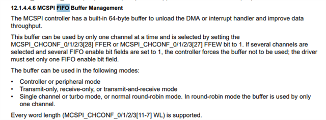

In mcspi/v0/mcspi.h, FIFO Length is defined as below:
#define MCSPI_FIFO_LENGTH (64U) |
Can we increase the value? if yes, what's the maximum fifo length a user can set?
The FIFO length is set to 64 only.
This cannot be changed.
