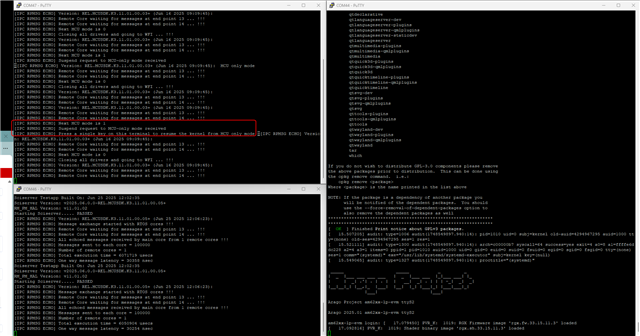

I'm testing Low  Power mode UART awake in sk-am62x-lp PROC124E1, but it always failed to wait up when MCU_UART_0 is received some key. The key signal is measured and confirmed is in MCU_UART_0. The picture below shown the COM log. The Linux prompt will restart itself after  "echo mem > /sys/power/state" command is entered. Time around 3 minutes (without or without any key is pressed).
I'm using tisdk-default-image-am62xx-lp-evm-11.01.05.03.rootfs.wic.xz image with SD card boot.
Please give some advises how to wake up, do I required to configure any device tree for wake up mode?

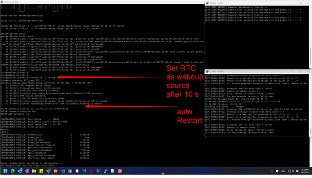

    I found some guideline for RTC as wakeup source and the result is in the picture below. It still not wake up and reset the system after around 2-3min.
    Any advises
    This information is from an old SDK version. Please use the SDK documentation for your version: https://software-dl.ti.com/processor-sdk-linux/esd/AM62X/11_00_09_04/exports/docs/linux/Foundational_Components/Power_Management/pm_low_power_modes.html

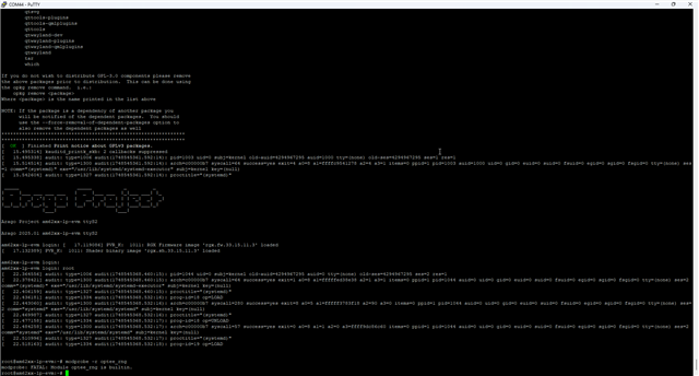

    Currently my evk is a GP devices. As following the link provided above, there is a limitation in GP devices.
    But I have a FATAL response as picture below. Any advise ?
    I'm not sure if LPMs have been tested with GP devices. I'll need to check internally and get back to you.

    The latest SDKs don't support GP silicon anymore so we haven't tested LPMs with GP silicon.
    There was a known bug with LPMs with GP silicon a few years ago that was patched with this commit: https://github.com/OP-TEE/optee_os/commit/31b38740db7f78bcd11b62e19a16fb4fcab64b03
    You can try adding this patch and re-building the OPTEE but there is limited support we can provide.

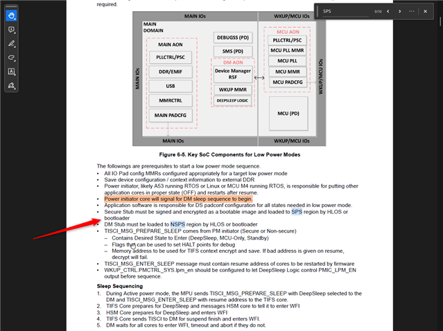

  • What is secure stub as showing in picture below, is it TIFS?
    Yes, the secure stub is the TIFS stub.

    As mentioned from that question thread, my final objective is to develop low power mode test by using bare metal code running in the R5 core only. From the sample code study, I have put the dm_stub code under TCM memory regions. But I noticed the code stucked (not able to read/write certain register mentioned by the code) somewhere when the code stucked somewhere in disable_main_lpsc() code, where psc_raw_lpsc_set_state is trying to set certain lpsc into disable mode.
