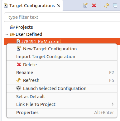

    Run :
    • To run MATHLIB/DSPLIB/FFTLIB kernels on a PC/HE :
      • Release : bin/Release/test_MATHLIB_<kernel_name>_<device>_x86_64/bin/Release/test_DSPLIB_<kernel_name>_<device>_x86_64/bin/Release/test_FFTLIB_<kernel_name>_<device>_x86_64
      • Debug :  bin/Debug/test_MATHLIB_<kernel_name>_<device>_x86_64/bin/Debug/test_DSPLIB_<kernel_name>_<device>_x86_64/bin/Debug/test_FFTLIB_<kernel_name>_<device>_x86_64
      • Open the scripting console in CCS - Go to the View menu and then select Scripting Console
      • Load the launch.js script as shown below (modify path to match the path on your machine if necessary).: "loadJSFile ("/ti/j7/workarea/pdk/packages/ti/drv/sciclient/tools/ccsLoadDmsc/j784s4/launch.js")"
      • After script completes execution you should see below in Debug window. You can connect to any core and load the corresponding application binaries.
      • Go to the Run menu and then select Load -> Load Program
      • In the Load Program window, browse to application binary you want to load.
      • Go to the Run menu and then select Resume to start executing demo binary.
