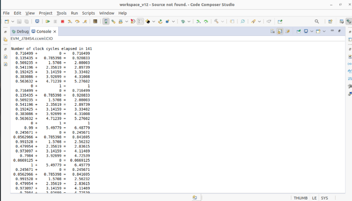

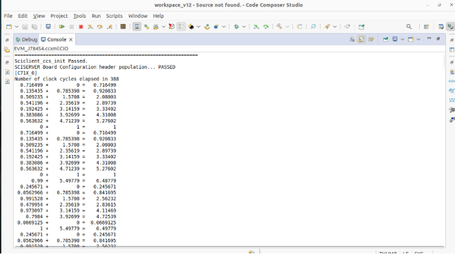

    When TSC register is used inside the code to measure the cycle counts, the following counts were observed from each cores:
     DSP Core
    C71x_0
    C71x_1
    C71x_2
    C71x_3
    Cycle Count
    368
    368
    368
    368

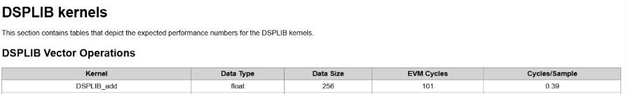

    These are the expected cycle counts from the dsplib userguide performance summary:
    Observation:
    The cycle count has increased by 3.64 times compared to the expected value from the performance report.
    Reason:
    An increase in cycle counts is observed in the standalone code compared to the test code, as cache is enabled in the test code, which helps reduce cycle counts.
    Solution:
    The solution is enabling the cache and mmu within the standalone example code.

      Updated Performance:
      DSP Core
      C71x_0
      C71x_1
      C71x_2
      C71x_3
      Cycle Count
      141
      141
      141
      141
      Observation:
      There is a 2.6 times decrease in cycle counts when cache and mmu is enable within the code and cycle counts are close to the reference count mentioned with the DSPLIB performance summary.
