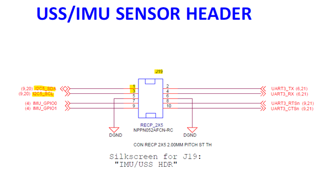

I have set the Pinmux Config to GPIO for Pins(Y25, R28, W23, Y24), as I am not really sure which two out of those four are actually mapped to the J19 connector on GESI Board
I could see that the registers are configured as expected, and the GPIO output is also updated on the GPIO0_MEM_OUT_DATA01, as well as GPIO0_SET_* and GPIO0_CLR_* registers.
So, my expectation is I should be able to see the I2C5_SCL(R28 or Y24) and I2C_SDA(Y25 or W23) toggle from high to low and low to high, but I don't see any change on the Scope.
I suppose only the *SET* and *OUT* should show the expected output and *CLR* should be opposite to *SET*. If that is how it is supposed to be, then it looks like for some reason SET and CLR instructions are happening at almost next to each other, which makes the pin always stay low.
Could you kindly let me know, if I miss something or how could I get it to work?

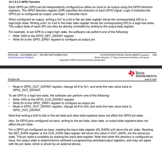

    Take a look at the following snippet from the TRM for more information on the SET and CLR registers:

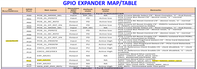

    Before this, can you confirm if you are setting the MDIO_MDC_SEL0?
    Based on the GESI board schematic, this select bit is used to mux I2C5, using chip U34, out to the headers. The MDIO_MDC_SEL0 is set by controlling the GPIO Expander via the I2C0 bus. This may be why you are unable to see any output on the I2C5 bus.
    Neehar
  • Hi Neehar,

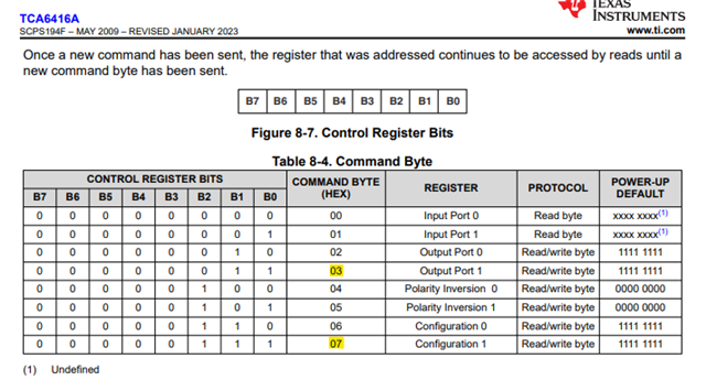

    Unfortunately that didn't seem to work. I have configured the MUX2_EXP pin (P15) as exepected,
    Wrote 0xDF to 0x07
    and 0xDF to 0x03 (Low) or 0xFF  to 0x03 (High)
    I have tried setting the output pin (MUX2_EXP or MDIO_MDC_SEL0) to both High and Low, and in both cases I see no change on the I2C5 lines.

    Can you confirm if the MDIO_MDC_SEL0 is set to high with a scope?
    Additionally, can test if you can control the TCA6424 GPIO expander using the I2C0 bus as well as it is address 0x22 on the bus?
    Neehar
  • Hi Neehar,
    I'd have to check that. I have only verified that this Pin is set as Output and High, by reading the 16pin GPIO Expander's registers.
    The MDIO_MDC_SEL0 is on I2C0 0x20, right?
    But to answer your question, Yes, I can control the 24pin GPIO Expander. I am able to toggle the USER_LEDs on I2C0 0x22.
    Thanks.
    Moses
  • Can you confirm if the MDIO_MDC_SEL0 is set to high with a scope?
    Yes, I confirm that this pin is set to High using a Scope.

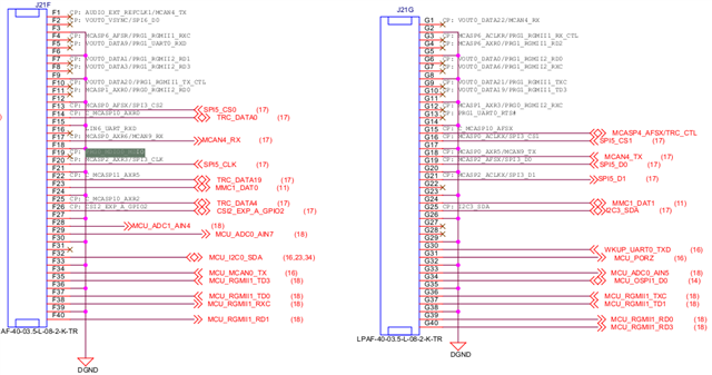

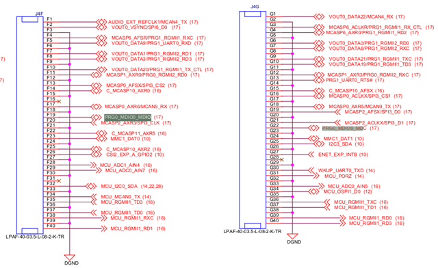

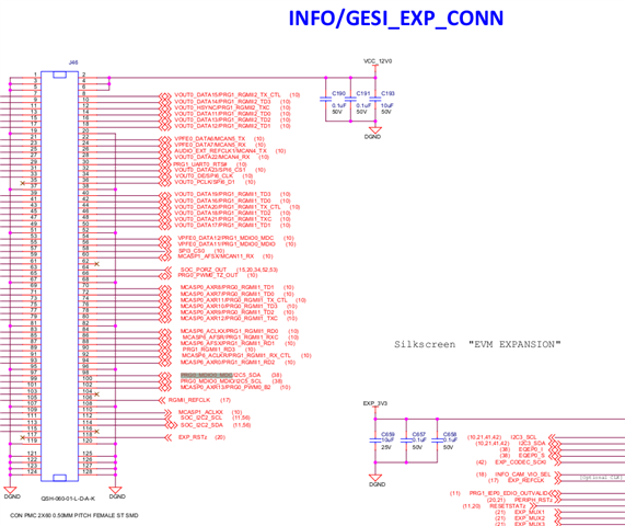

    I have looked deeper into the schematics for the SOM, CPB, and GESI board and it seems the source signals for I2C5_SCL and I2C5_SDA are not outputted from the J721S2 SOM. The signal is outputted from the GESI board using the Mux I have shown below with the select bit MDIO_MDC_SEL0 as we discussed before.
    However, PRG0_MDIO0_MDIO and PRG0_MDIO0_MDC are the sources for I2C5_SCL and I2C5_SDA respectively from the SOM, through the Common Processor Board (CPB), and to the GESI board. The SOM to CPB connector for J721S2 does not output the source signals for PRG0_MDIO0_MDIO and PRG0_MDIO0_MDC as shown in the image below. It is expected on pins F19 and G22.
    I also compared this to the J721E SOM and you can see the signal is connected through the SOM, to the CPB, and all the way to the GESI board as shown in the images below on pins F19 and G22.
    SOM to CPB connection:
    CPB to GESI connection:
    Since it is not connected, you will not be able to use I2C5_SCL or I2C5_SDA on the GESI board with the J721S2 SOM. Feel free to reach out if you have any further questions.
