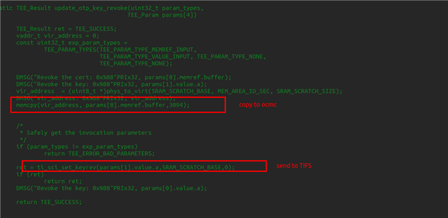

Dear champ,
My customer had developed Key Revoke feature in u-boot by working with Sitara AE Hong Guan.
Now we need some help for same implementation on DRA821 since TISCI in SYSFW is different from DRA821 to AM64x and AM62x.
OPTEE is required for the implementation.
Attached files are the modifications were created for Sitara part.

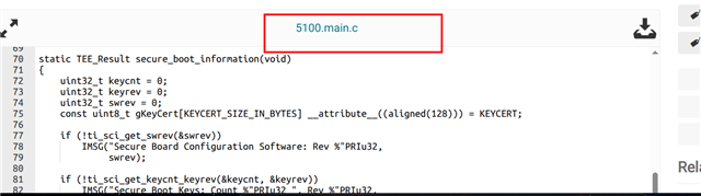

static TEE_Result secure_boot_information(void)
	uint32_t keycnt = 0;
	uint32_t keyrev = 0;
	uint32_t swrev = 0;
	const uint8_t gKeyCert[KEYCERT_SIZE_IN_BYTES] __attribute__((aligned(128))) = KEYCERT;
	if (!ti_sci_get_swrev(&swrev))
		IMSG("Secure Board Configuration Software: Rev %"PRIu32,
		     swrev);
	if (!ti_sci_get_keycnt_keyrev(&keycnt, &keyrev))
		IMSG("Secure Boot Keys: Count %"PRIu32 ", Rev %"PRIu32,
		     keycnt, keyrev);
	/* unit test for ti_sci_set_keyrev() */
	IMSG(">>>> ti_sci_set_keyrev() unit test start");
	if (!ti_sci_set_keyrev(&gKeyCert[0], KEYCERT_SIZE_IN_BYTES))
		IMSG(">>>> ti_sci_set_keyrev() return success!!!");
	return TEE_SUCCESS;
service_init_late(secure_boot_information);

  • HI Rich
    Based on the earlier implementation i assume you want to update the KEYREV value using optee interface not using uboot. If that is the case you can use the same code on DRA821 as well .
    Eventually OPTEE is making use of TIFS service to update the value in the effuses. These APIs are still valid for DRA821 as well.One thing which we need to make sure that we have enabled the VPP before burning anything on to the effuses.
    Diwakar

  • Hi Rich,
    They are copying the dual signed certificate to scratch memory before sending it to TIFS. You can also use the OCMC memory on DRA821.
    MCU_MSRAM_1MB0_RAM      0x0041C000000 - x0041CFFFFF  (1 MB)
    Diwakar

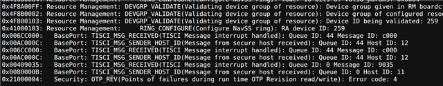

  • U-Boot SPL 2024.04-ged60d191-dirty (Aug 14 2025 - 16:01:32 +0800)
    SYSFW ABI: 4.0 (firmware rev 0x000b '11.0.9--v11.00.09+ (Fancy Rat)')
    Hi Ti
    It still do not work. I include dual_cert_keyrev.h , same as tiboo3.bin for change CUP type (HS-FS -> HS-SE)
    DDR type: Micron LPDDR4 4G
    Trying to boot from SPI
    Authentication passed
    Loading Environment from SPIFlash... *** Warning - bad CRC, using default environment
    Starting ATF on ARM64 core...
    NOTICE: BL31: v2.10.0(release):ed60d191-dirty
    NOTICE: BL31: Built : 16:02:47, Aug 14 2025
    I/TC:
    I/TC: Primary CPU initializing
    I/TC: SYSFW ABI: 4.0 (firmware rev 0x000b '11.0.9--v11.00.09+ (Fancy Rat)')
    I/TC: Secure Board Configuration Software: Rev 1
    I/TC: Secure Boot Keys: Count 2, Rev 1
    I/TC: >>>> ti_sci_set_keyrev() unit test start
    I/TC: req.value = 0x00000002
    I/TC: req.cert_addr_lo = 0x41C00000
    I/TC: req.cert_addr_hi = 0x00000000
    I/TC: req.hdr.type = 0x9035
    I/TC: req.hdr.host = 0xB
    I/TC: req.hdr.seq = 0x4
    I/TC: req.hdr.flags = 0x2
    E/TC:0 0 ti_sci_set_keyrev:516 >>>> ti_sci_do_xfer() failed with ret = 0xffff0001

  • --- a/k3-image-gen/ti-optee-os/core/arch/arm/plat-k3/drivers/ti_sci.c
    +++ b/k3-image-gen/ti-optee-os/core/arch/arm/plat-k3/drivers/ti_sci.c
    @@ -34,7 +34,7 @@ struct ti_sci_xfer {
    struct k3_sec_proxy_msg rx_message;
    -#define SRAM_SCRATCH_BASE 0x43C3B000
    +#define SRAM_SCRATCH_BASE 0x0041C00000
  • Hi Chen,

    • make  below change in config.mk to avoid any stack related issue.
      CFG_STACK_THREAD_EXTRA ?= 150000
    See if it works.
    Diwakar

    Below are the reference patchs which I tested at my end on TI EVM. I checked the TIFS traces and the call reaching to TIFS and validation of dual certificate is passing.
    It should work if we enable the VPP. I am working internally to test this on sockected board, which will take some time.In the meantime, customer can do similar changes .
    optee_example reference patch:
    https://e2e.ti.com/cfs-file/__key/communityserver-discussions-components-files/791/optee_5F00_example_5F00_keyrevoke.patch
    optee_os trusted application patch:I am copying the dual cert to 0x41CFEFFF address as it is not used by any component on TI EVM.
    https://e2e.ti.com/cfs-file/__key/communityserver-discussions-components-files/791/trusted_5F00_application_5F00_patch_5F00_optee_5F00_os.patch
    Board config changes :
    diff --git a/board/ti/j721s2/sec-cfg.yaml b/board/ti/j721s2/sec-cfg.yaml
    index d0f3a161..9fc786e4 100644
    --- a/board/ti/j721s2/sec-cfg.yaml
    +++ b/board/ti/j721s2/sec-cfg.yaml
    @@ -248,104 +248,104 @@ sec-cfg:
             subhdr:
                 magic: 0x4081
    -        write_host_id: 0
    +        write_host_id: 11
    TIFS traces on TI EVM.
    Here error code 4 means certficate validation passed and failed and while writing to OTP as VPP is not enabled.
    Diwakar

    optee_example_keyrevoke.patch is a CA patch, Here we are sending dual signed cert to optee trusted application, my dual signed cert is included in the form of header file keycert.h. I am passing the address of this cert to TA.
    trusted_application_patch_optee_os.patch is a trusted application patch. In this patch, we are copying the dual cert to OCMC memory and then sending it to TIFS.
    Diwakar

    Not sure if i understood your question correctly, i generated the client application and copied to my rootfs.
    After booting the device I ran my application like
    /optee_example_otp_keyrev
    Diwakar
