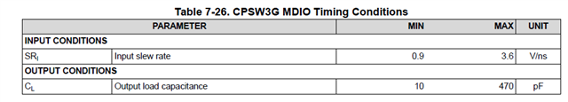

  1. In my device, the actual measured input slew rate for MDIO is 0.14V/ns, which is not within range of 0.9V/ns ~ 3.6V/ns as specified in Table 7-26. CPSW3G MDIO Timing Conditions. The maximum data rate of MDIO for my application is only 625kHz.
  • Is the Input slew rate specification in Table 7-26 applicable to higher data rate e.g. 5MHz only?

    The minimum Input Slew Rate parameter defined in each Electrical Characteristics table is associated with long-term reliability.
    The minimum Input Slew Rate parameter defined in each peripheral timing section is a requirement to meet the respective peripheral timing parameters.
    The device may not work as expected if you violate the minimum input slew rate limit defined in the respective peripheral timing section, but the device could be permanently damaged if you violate the minimum input slew rate limit defined in the respective Electrical Characteristics table. It is very important that you minimize the time a signal connected to one of our input buffers spends in the mid-supply region as it transitions from low to high or high to low.

    The peripheral slew rate is for performance and the LVCMOS IO slew rate is for IO reliability.
    Sreenivasa

    I tried to understand the relationship between the slew rate limit with data rate.
    Signal Maximum data rate [bps] 7.8.6 LVCMOS Slew Rate
    = 33*f [V/ns]
    Respective peripheral specification in Chapter 7.11 [V/ns]
    UART 12,000,000 0.396 0.5 ~ 5
    MDIO 2,500,000 0.0825 0.9 ~ 3.6
    MSPI 50000000 1.65 2 ~ 8.5
    For UART and MSPI, the peripheral slew rate is close with the LVCMOS slew rate if using the formula 33*toggle frequency.
    Could you please help to confirm the maximum data rate on MDIO that used for peripheral slew rate limit?
    Since my application do not use maximum data rate, is it make sense to re-consider the peripheral slew rate limit based on actual input toggle frequency instead of maximum data rate?

    The recommendation is to follow the slew rate requirements mentioned for each of the peripherals when the LVCMOS IOs are configured for specific functionality.
    Sreenivasa
