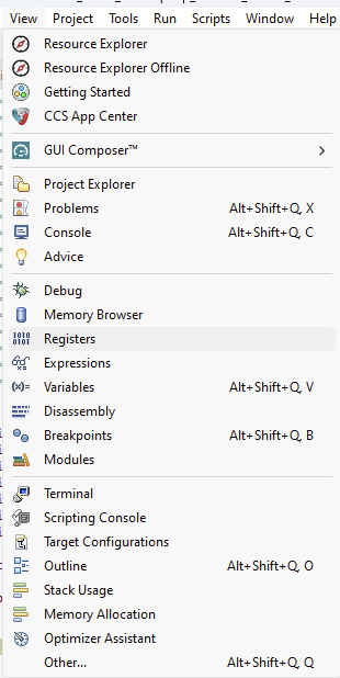

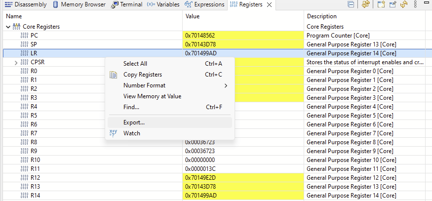

4. Selected View > Registers
5. Exported the required registers from the register window

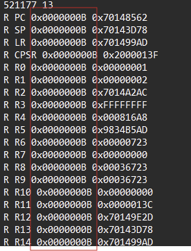

6. Exported it as a text file and opened it
7.
Q. I can see that that value in the last column is the register value, but what is in the second last (3rd) column?
Q. What is the 521177 13 value at the top?
Aswin
    It is an internal value that represents the register width. It is something that is not really needed in an exported file. We will be removing this column when we implement the export feature in CCS 20.x.
    This is another internal value that is not really needed in an exported file. It is an ID used internally by CCS to represent the file type. We will be removing this header when we implement the export feature in CCS 20.x.
