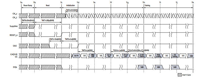

  • During boot, the RESET_N signal on LPDDR4 goes high after the SPL Stage 1 on our custom board. However, it consistently remains low in TI EVM.
    According to the LPDDR4 datasheet, RESET_N should transition high during initialization.
  • The reset signal does go high on the EVM when the bootloader loads correctly.  It may not be going high because boot is failing.
    James
  • The SoC bootloader loads correctly. Our concern is with the DDR0_RESET_N signal of the LPDDR4, which goes high on our custom board.
    However, according to the DDR datasheet, the timing diagram it also indicates a RESET_N high during  initilization. but during spl stage 2 error message recieve:

    Please check whether the reset signal (RESET_N) is high during initialization.
    Also, how can we obtain detailed logs for this process?
  • This seems to be the same question: https://e2e.ti.com/support/processors-group/processors/f/processors-forum/1549818/am62a7-error-at-the-time-flashing-sbl_uart_uniflash_stage2-release-appimage-hs_fs----incorrect-magic-number-in-response-header
    Please try the steps from this thread.  Also send schematic and implement the patch as mentioned.  The RESET signal will conform to the timing diagram when the board is properly booting.
