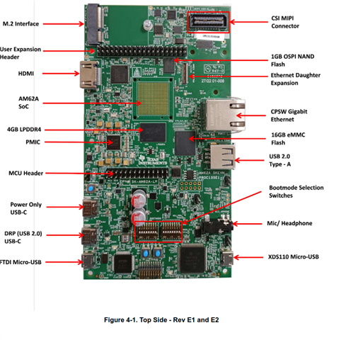

  • Hi Rio,
    In case of AM62A which supports OSPI-NAND flash uses -1Gbit OSPI memory device from Cypress Part# W35N01JWTBAG
    Please refer the section '4.5.10.2 OSPI Interface' of AM62A EVM board userguide
    Link:- https://www.ti.com/lit/ug/spruj66a/spruj66a.pdf?ts=1754544286840&ref_url=https%253A%252F%252Fwww.google.com%252F
    As per my understanding we need to use 1Gb size SPI NAND Flash. Let me double check with our hardware expert and get back to you.
    Dilna K
