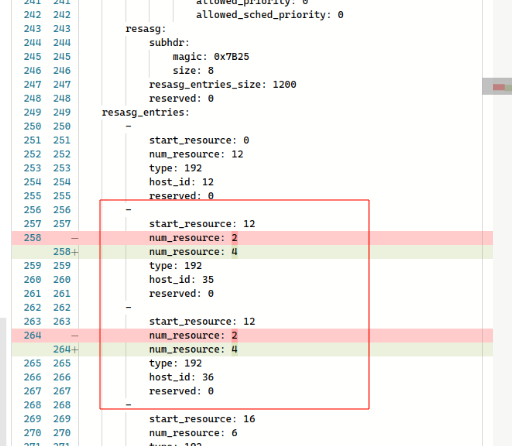

  • Hi  Neehar,
        i follow the instruction : ://software-dl.ti.com/jacinto7/esd/processor-sdk-rtos-j722s/11_00_00_06/exports/docs/mcu_plus_sdk_j722s_11_00_00_12/docs/api_guide_j722s/TOOLS_SYSFW.html#BOARCFG_GEN
       and finally not make the change effective,  could you help me to check what' wrong here?
    my step is:
    1. instead of use syscfg, i just modify the source code : mcu_plus_sdk_j722s_11_00_00_12/source/drivers/sciclient/sciclient_default_boardcfg/j722s/sciclient_defaultBoardcfg_rm.c
    move 4 resource from linux to wkup domain.
        .resasg_entries = {
                .num_resource = 12,
                .type = TISCI_RESASG_UTYPE (TISCI_DEV_MAIN_GPIOMUX_INTROUTER0, TISCI_RESASG_SUBTYPE_IR_OUTPUT),
                .start_resource = 0,
                .host_id = TISCI_HOST_ID_A53_2,
            // give 4 to wkup mcu from linux
                .num_resource = 4,
                .start_resource = 12,
                .host_id = TISCI_HOST_ID_WKUP_0_R5_1,
                .num_resource = 4,
                .host_id = TISCI_HOST_ID_WKUP_0_R5_0,
                .num_resource = 6,
                .start_resource = 16,
                .host_id = TISCI_HOST_ID_MAIN_0_R5_1,
    2.  build:
    make -C mcu_plus_sdk_j722s_11_00_00_12/tools/sysfw/boardcfg SOC=j722s
    make -C mcu_plus_sdk_j722s_11_00_00_12 libs DEVICE=j722s
    // make app
    make -C
    mcu_plus_sdk_j722s_11_00_00_12/examples/vt_mcu00_app/j722s-evm/wkup-r5fss0-0_freertos/ti-arm-clang
    make -C ${SCRIPT_PATH}/../../sdk_builder uboot
    then get the tispl.bin   and copy to sdcard
    3. test
    my app is  try to make 3 route,
    param order is   (uint32_t srcId, uint32_t srcIdx, uint32_t dstId, uint32_t dstIdx)
        Sciclient_gpioIrqSet(TISCI_DEV_GPIO1, 12, TISCI_DEV_WKUP_R5FSS0_CORE0, CSLR_WKUP_R5FSS0_CORE0_INTR_MAIN_GPIOMUX_INTROUTER0_OUTP_12);
        Sciclient_gpioIrqSet(TISCI_DEV_GPIO0, 35, TISCI_DEV_WKUP_R5FSS0_CORE0, CSLR_WKUP_R5FSS0_CORE0_INTR_MAIN_GPIOMUX_INTROUTER0_OUTP_13);
        Sciclient_gpioIrqSet(TISCI_DEV_GPIO0, 36, TISCI_DEV_WKUP_R5FSS0_CORE0, CSLR_WKUP_R5FSS0_CORE0_INTR_MAIN_GPIOMUX_INTROUTER0_OUTP_14);
    and result is
    4722: Sciclient event config: 78-12, 121-44: -1
    9712: Sciclient event config: 77-35, 121-45: -1
    14695: Sciclient event config: 77-36, 121-46: -1
    all alloc failed.

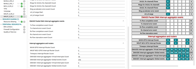

     i still fail to get resource in wakeup mcu.
    here is my step.
    1. i use mcu_sdk_plus/example/ipc/ipc_rpmsg_echo_linux as project, is that correct, or need to other special project to enable rm configuration?
    2. i open sysconfig 1.20 and use  'linux-adas-v11/board-support/k3-respart-tool/out/j722s-evm.syscfg` as base configure, then move 4 main gpio mux resource from linux to wkup domain.  result in rm-cfg.yaml is
    3. i copy this rm-cfg.yaml to "linux-adas-v11/board-support/ti-u-boot-2025.01+git/board/ti/j722s/ " , replace the origin one.
    4. compile the wakup project and make -C sdk-builder uboot  to generate tispl.bin  , copy to sdcard boot partition, replace the old one.
    5. wkup project run code
            req.type = TISCI_DEV_MAIN_GPIOMUX_INTROUTER0;
            req.subtype = TISCI_RESASG_SUBTYPE_IR_OUTPUT;
            req.secondary_host = TISCI_HOST_ID_MAIN_0_R5_1 ; // TISCI_HOST_ID_WKUP_0_R5_1;
            Sciclient_rmGetResourceRange(&req, &resp, 0xFFFFFFF);
            DebugP_log("main20 resouce : %d %d\n",  resp.range_start, resp.range_num );
            // this is 16,6
            req.secondary_host = TISCI_HOST_ID_WKUP_0_R5_1;
            DebugP_log("wkup  resouce : %d %d\n",  resp.range_start, resp.range_num );
    main20 resouce : 16 6
    wkup resouce : 0 0
    wkup still not get any resource, could you help me to check what's wrong i made? thanks.

    Thanks, I am looking through this. Are the only changes you made moving all 4 resources from Linux A core to WKUP R5?
    i copy updated mcu_plus_sdk_j722s_11_00_00_12/examples/drivers/boot/sbl_sd/j722s-evm/wkup-r5fss0-0_nortos/ti-arm-clang/tiboot3.bin  to sdcard BOOT partition to replaced the prebuilt one, linux cant boot, only wakeup mcu print
    With the updated steps, do you still have issues with Linux boot?

    Could you please confirm the only changes you made to the rm allocations moving all 4 WKUP GPIO Interrupt Router resources from Linux A core to WKUP R5?
    Neehar
     yes, you can compare it to origin sdk code.
