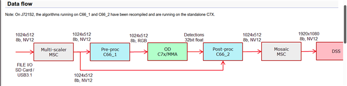

We are currently conducting load pressure tests for the DSP MMA.
By running the app_tidl_od program under the vision_apps directory, we found that only the C7x_1 load was full. According to the datasheet, there are two MMA in the TDA4VPE. Therefore, we ran the second app_tidl_od program and set the TIDLNode node to C7x_2.
However, we found that when running one app_tidl_od, the load on the C7x could reach 100%, but when running the second app_tidl_od, the load on both C7x was 66%. Therefore, we believe that there is resource competition between the two app_tidl_od, which led to the inability of the C7x MMA to operate at full capacity.
And we would like to know if there is any way to obtain the load of MMA, or we can simply assume that when the C7x load is 100%, then the load of MMA is also 100%.

 TIDL Demo - Object Detection
 p: Print performance statistics
 x: Exit
 Enter Choice: app_tidl_od: Iteration 0 of 1000000000 ... Done.
 x: Exit
 Enter Choice: p
Summary of CPU load,
CPU: mpu1_0: TOTAL LOAD =  19.53 % ( HWI =   0.69 %, SWI =   0.11 % )
CPU: mcu2_0: TOTAL LOAD =   7. 0 % ( HWI =   0. 0 %, SWI =   0. 0 % )
CPU: mcu2_1: TOTAL LOAD =   2. 0 % ( HWI =   0. 0 %, SWI =   0. 0 % )
CPU: mcu3_0: TOTAL LOAD =   1. 0 % ( HWI =   0. 0 %, SWI =   0. 0 % )
CPU: mcu3_1: TOTAL LOAD =   1. 0 % ( HWI =   0. 0 %, SWI =   0. 0 % )
CPU: mcu4_0: TOTAL LOAD =   1. 0 % ( HWI =   0. 0 %, SWI =   0. 0 % )
CPU: mcu4_1: TOTAL LOAD =   1. 0 % ( HWI =   0. 0 %, SWI =   0. 0 % )
CPU:  c7x_1: TOTAL LOAD =  98. 0 % ( HWI =   0. 0 %, SWI =   0. 0 % )
CPU:  c7x_2: TOTAL LOAD =   0. 0 % ( HWI =   0. 0 %, SWI =   0. 0 % )
CPU:  c7x_3: TOTAL LOAD =   0. 0 % ( HWI =   0. 0 %, SWI =   0. 0 % )
HWA performance statistics,
HWA:   MSC0: LOAD =  65.54 % ( 429 MP/s )
DDR performance statistics,
DDR: READ  BW: AVG =   2175 MB/s, PEAK =   4205 MB/s
DDR: WRITE BW: AVG =   1038 MB/s, PEAK =   2378 MB/s
DDR: TOTAL BW: AVG =   3213 MB/s, PEAK =   6583 MB/s

    Based on the attached dataflow, the C7x is used for both pre/post-processing and detection.
    In Case 1, all operations are performed on c7x_1, whereas in Case 2, detection is handled by c7x_2.
