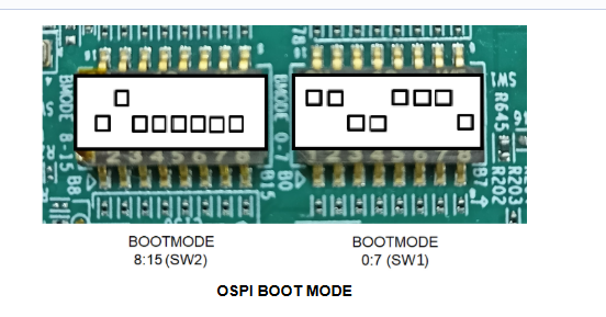

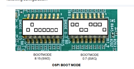

    Moreover, since you are using SK-AM62B-P1 I am assuming the flash on it is S28HS512T, hence can you confirm if the bootmode pins are set to the following configuration?
    If yes, you are on the right track.

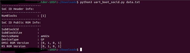

    • Please tell me if your board is GP or HSFS, check it here:  [FAQ] [AM6XX]: How to check if device type is HS-SE, HS-FS or GP?
    • Also check the exact board which you have is it AM62X-SK or AM62X-SK-LP or AM62X-SIP-SK.
    • If your device type is HS FS then you would need to flash the HS FS images while doing UART Uniflash step(The python script which you run "python uart_uniflash.py -p ......")
    Looking forward to your response.
    Vaibhav
  • Hi Vaibhav,
      Ans: I have followed the link you posted, run the Python script, and confirmed that my board is GP.

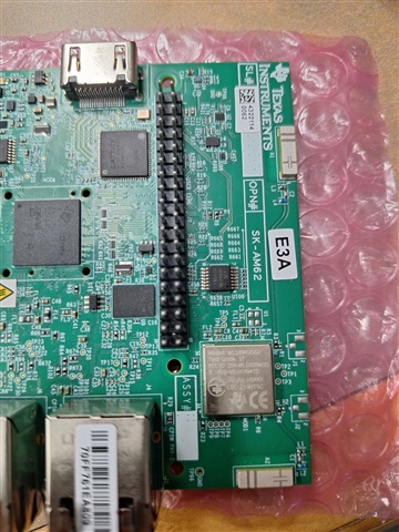

      Ans:   board is  SK-AM62x

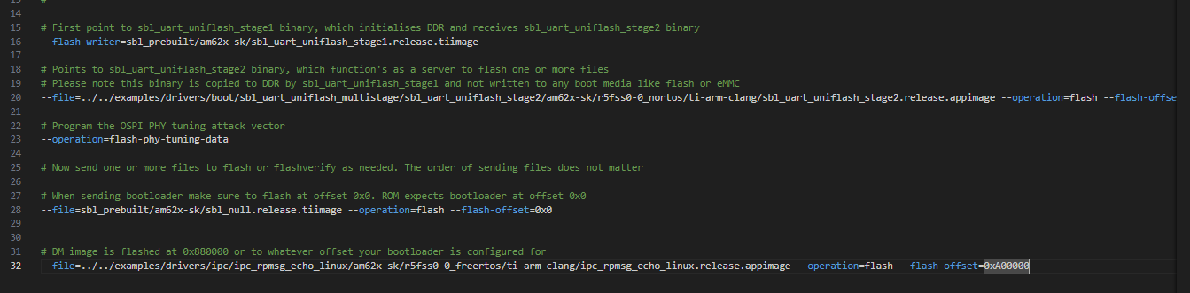

             Script I have run for this board
             For SK-AM62
         cd ${SDK_INSTALL_PATH}/tools/boot
         python uart_uniflash.py -p COM<x> --cfg=sbl_prebuilt/am62x-sk/default_sbl_null.cfg

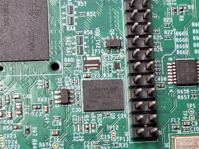

    I have a question about the OSPI NOR bootloader issue on the SK-AM62x. I followed the link where you mentioned that booting doesn’t work in OSPI NOR mode. Since I’m currently flashing via OSPI NOR, is there an alternative method I can use? By the way, the flash on my AM62 board is a Cypress 28HS512T.
    Link where the OSPI BootMode doesn't work:
    https://e2e.ti.com/support/processors-group/processors/f/processors-forum/1551867/faq-am62x-am62px-am62d-q1-am64x-am275x-s28hs512t-does-not-boot-in-ospi-bootmode
    Flash present on my board (SK AM62x)

  • Hi Raj,
    The FAQ which you saw was on why S28HS512T does not boots in OSPI bootmode.
    The bootmode which you must have set is as follows:
    This although labeled currently as OSPI, it is actually xSPI bootmode. This is a documentation bug which will be addressed. So xSPI bootmode is fine.

    For the default SBL Null, my assumption is that you have not changes any of the files, and you flashed the files in its default form:
    Once flashed, go to CCS and when you connect to the core R500, please head to Call Stack to see what address it is showing/stuck at? I need this to be able to move forward.
