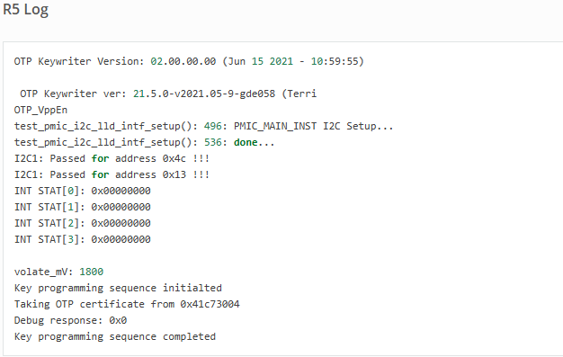

  • Hi Grace,
    full log would be as below.

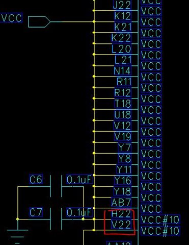

    First, can you confirm if VPP (#H22) is supplied to 1.8V?
    regards,
    Lloyd
  • VPP (#H22) is supplied to 1.8V, but H22 and V22 are connect together with VDDA_xx signals. Will this cause any issue?
    At which stage shall we power up 1.8v? Our current sequence is 3.3V -> 1.8V -> 0.8V -> 0.85V -> 1.1V -> release RST. Thanks.

  • They confirmed that there is no problem with the SD card they are using.
    I used the same SD card on a customer board and got the following UART logs.
    Could you please check what else could be causing the issue?
    [First attempt - success]
    OTP Keywriter Version: 02.00.00.00 (Apr 18 2025 - 10:22:16)
    OTP Keywriter ver: 8.4.6-v08.04_keywriter (Jolly J
    OTP_SciClientInit
    READ BOARD_MCU_GPIO12_PINMUX_ADDR: 0x00050007
    VPP enable
    Key programming sequence initialted
    Taking OTP certificate from 0x41c7f004
    Debug response: 0x0
    Key programming sequence completed
