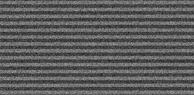

  • Hi Gokul,
    Sorry, I check all the output pyramid pictures,it seems that all level's picture of pyramid are ok. But threr is anoter problem, some of the output picture is not ok. Some frames of the pictures is like the picture bellow,every three frames of the output pictures have two  frames like the picture bellow,   do you know why?

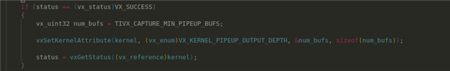

  • Hi Cheng,
    Which application are you running and describe how are you dumping the frames in sequence.
    How is your graph created ? is pipelining enabled ?
    Gokul
  • It's the vx_app_single_cam application, in the application i add color convert ,scaler and pyramid node,  the pipieline is same as the origin app(but delete the buf size code),it seems tha the buf of the pipeline input must be greater than 4,  can you tell me why?

  • Hi Cheng,
    Yes, because for running capture_node in pipeline we set minimun pipeup buffers which is 3, so you have to atleast enqueue 3 buffers to capture node.
    And if you are running in pipeline mode then you should add output of pyramid  node as graph parameter and save it to file.
    Gokul
  • In the app, i do not add the graph parameter, but it can also save the pyramid output to file, it also works for the scaler node, what's the difference between add the node parameter and not to add it, and can you tell me the effect of it ? The above picture , which is not normal , is the affect of the graph parameter?
  • Hi Cheng,
    If you running in pipelining mode it is not recommended to save the images directly without creating it as graph parameter. As the buffers are used by the framework you may end up with some corruption. making it as graph parameter will give you the control of buffer to application.
    Refer to  Node and Graph Parameter Definitions in the user guide.
    Gokul
