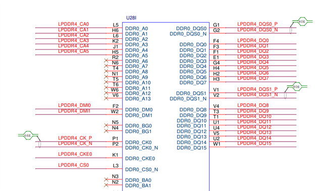

We are currently designing a custom board using the AM62L processor with LPDDR4 memory and have noticed discrepancies in the impedance requirements for LPDDR4 signal routing.
  1. In the EVM schematic, the specified impedance is:
    • 66Ω for LPDDR4_CK_P/N
    • 80Ω for LPDDR4_DQSx_P/N

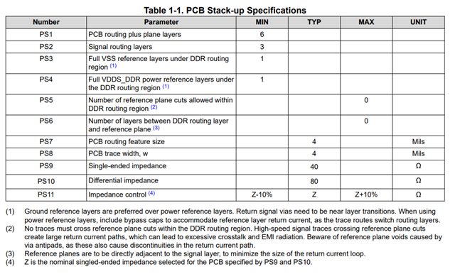

  3. In the LPDDR4 Routing Guidelines document, the recommendation is:
    • 80Ω differential
    • 40Ω single-ended
We have attached screenshots from the schematic, layout, and the routing guideline document for your reference.
Could you please confirm which impedance values we should follow for our custom board to ensure signal integrity.

  • The DDR guidelines app note parameters are "typical" so you can vary these, but i would recommend proper power aware board simulations to prove out signal integrity.
    I wasn't aware of the discrepancy with the schematic vs. layout, let me check.

  • Hi Jaydip, impedances of 40-50ohms SE and 80-100ohms differential are typical.  We list 40/80 as typical in the app note, but several customers have used 50/100.  I did confirm, as you pointed out, we used 50/100 on the EVM.
    James

  • 1. Not necessarily.  You may need to change drive strength and termination settings for your board.  The values we use for the EVM are specific to that board
    2. No,  keep the consistency across the interface.  The processor and memory will have both ODI/ODT settings for the whole bus anyway, you don't want any impedance mismatches within each bus
    I don't see any issues.  Other than the 50/100 impedances, it sounds like you are following all of the guidelines in the app note (BTW, we plan on changing the app note better indicate that 50/100 is ok).   Will you be performing board level simulations?  This will give you better confidence for a successful design.
