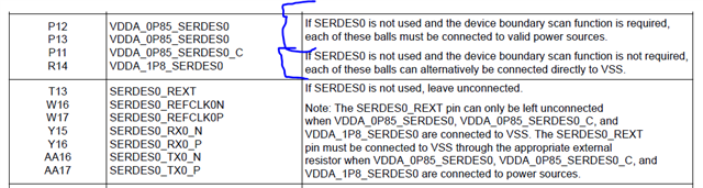

    SERDES0 here means either PCIe or USB3 interface
    Refer Table 5-80. Connectivity Requirements (continued) page 94
    P13
    P11
    R14
    VDDA_0P85_SERDES0
    VDDA_0P85_SERDES0
    VDDA_0P85_SERDES0_C
    VDDA_1P8_SERDES0
    If SERDES0 is not used and the device boundary scan function is required,
    each of these balls must be connected to valid power sources.
    If SERDES0 is not used and the device boundary scan function is not required,
    each of these balls can alternatively be connected directly to VSS.
    SERDES0 is the only peripheral that has the requirements related to boundary scan for AM64x.

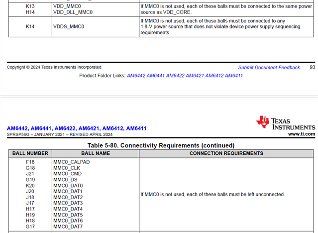

    MMC0 is for eMMC and the pin connectivity requirements is for a valid suppy to be connected.
    VDDA_3P3_SDIO  is intended to generate the IO supply for SD card connected on the MMC1 interface,
    VDDA_3P3_SDIO connected to VSS
    This is enabling the LDO.
    The VDDSHV1 SDIO supply when SD card is not used or UHS-I speed is not used is expected to be connected to a fixed 3.3V or 1.8V IO.
    So SERDES0 is the only peripheral which need to be powered to not break the BSDL chain ?
    The pin connectivity requirements allows SERDES0 to be disabled to save power and hence the recommendation to power the peripheral in case boundary scan is used.

    SERDES0 not used
    Has 2 cases, when boundary scan is used and boundary scan is not used

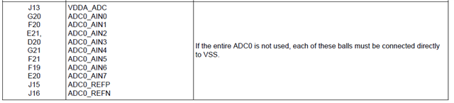

    ADC0 not used

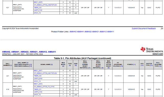

    MMC0 not used  (MMC0 is a hard phy implementation)
    MMC1 (SD card note used)
    LDO connection
    VDDSHV5
    Connect to a valid IO supply 1.8V or 3.3V based on the IO usage.
    The SDIO buffer supports configuring alternate muxed function
    Table 5-1. Pin Attributes (ALV Package)
    I have shown the data signals
    Same is true for CMD, SDCD and SDWP
