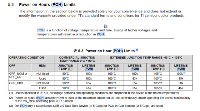

In datasheet, there is a POH table. I want to check how to check our OPP mode of AM57? Is this related to HW or power or SW?
Another question is do we have a lifetime report of different temperature, different core frequency?
