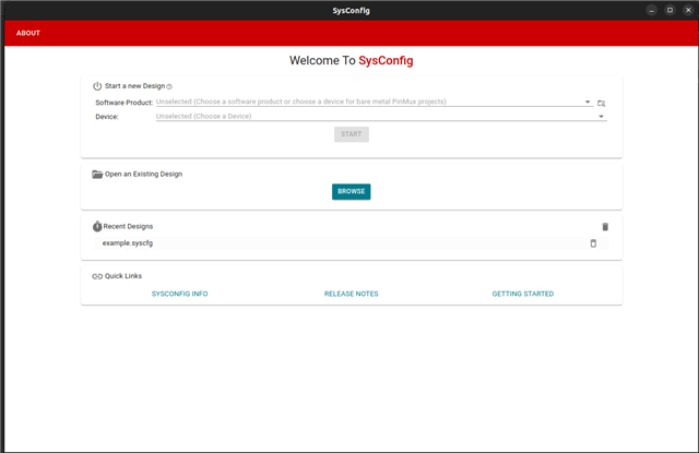

    You can open sysconfig-gui and load this file example.syscfg  present in each core's folder. Do the modification and save the file in the same place.
    once you build your sdk "make sdk" or "make vision_apps"  this .syscfg will be used to generate the code which will be reflected under generated directory.

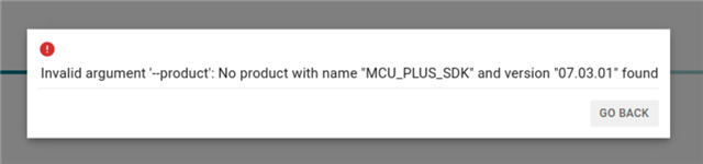

  • Hi Gokul,
       here is my step to open .syscfg in syscfg tool, but fails. could you help me to check what's wrong. thanks.
    1. run syscfg program. in my pc is :
    ./sysconfig_1.20.0/nw/nw  .
    2. load  .syscfg.
        in gui, click browse in "open an existing design", and chose .syscfg file which is "vision_apps\platform\j722s\rtos\mcu2_0\example.syscfg"
    3. then i got an error.
    Run this command to open sysconfig inside your sysconfig installed directory,
    Then browse Existing Design and open your example.syscfg file

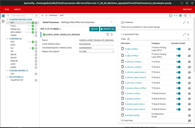

    after that you should see window like this,
    Modify your changes and save the file.
    I am using sysconfig on ubuntu 22.04 and it is working for me without any issue.
    Gokul

  • Hi Gokul,
       that's wired.
       1. i tried .syscfg in mcu_plus_sdk example and it's ok.  then compare these files, i found mcu20's syscfg comment is different.
    in L4:   * @cliArgs --device "J722S_TDA4VEN_TDA4AEN_AM67" --package "AMW" --part "Default" --context "main-r5fss0-0" --product "MCU_PLUS_SDK@07.03.01"
    but in mcu-sdk_plus examples, they are
     * @cliArgs --device "J722S_TDA4VEN_TDA4AEN_AM67" --package "AMW" --part "Default" --context "mcu-r5fss0-0" --product "MCU_PLUS_SDK_J722S@11.00.00"
        then i change mcu20's  --product param,  it works.
    it seems that sysconfig-tool would check the cliarg line in the head comment and do some configurations.
