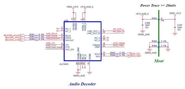

[SCHEMATICS]
[PINMUX]
B20
MCASP0_ACLKX
Audio
Audio out,Audio DAC ALC5629
D20
MCASP0_AFSX
Audio
E18
MCASP0_AXR0
Audio

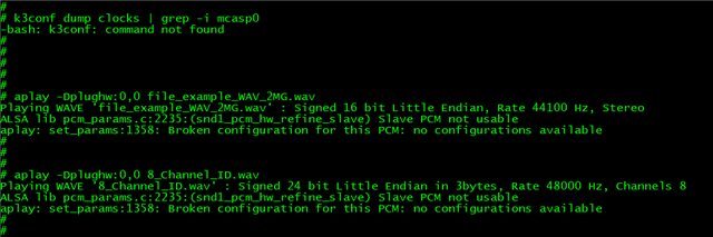

  • Hi Suren
    aplay -Dplughw:0,0 file_example_WAV_2MG.wav
    Playing WAVE 'file_example_WAV_2MG.wav' : Signed 16 bit Little Endian, Rate 44100 Hz, Stereo
    ALSA lib pcm_params.c:2235:(snd1_pcm_hw_refine_slave) Slave PCM not usable
    aplay: set_params:1358: Broken configuration for this PCM: no configurations available
    Daniel

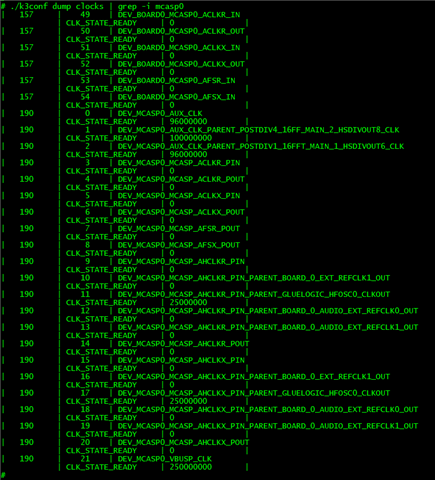

    Also can you share the output of k3conf dump clocks | grep -i mcasp0
    Suren
  • Hi Suren
    How to "output of k3conf dump clocks | grep -i mcasp0"?

    Also are you using tisdk-default-image (since you are not seeing k3conf on your end)?
    Suren
  • Hi Suren
    BCLK and WCLK Points to MCASP ACLKX and FSX pins that you have interfaced to the codec. You need to probe those pins on logic analyzer/oscilloscope and see if you are seeing the clocks
    => no clocks on ACLKX
    => we are using buildroot from TI

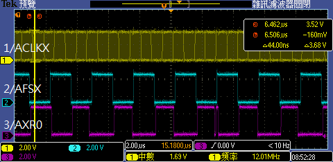

    We try to add mcasp_mclk in device tree and aplay cmd looks like playing wav file but still no sound.
    the logic analyzer/oscilloscope on MCASP0_ACLKX show 12MHz.

    Scott
  • Hi Scott,
    If you are seeing 12MHZ on ACLKX, Can you also probe FSX and AXR0 of MCASP0.
    Please share the screenshot of each of these when you are probing.
    Also, Can you use the default TISDK to build instead of buildroot and have the k3conf utility.
    Suren
  • Hi Suren
    Here is the k3conf dump by using prebuild img.
    The logic analyzer/oscilloscope on each three pins
    Scott
