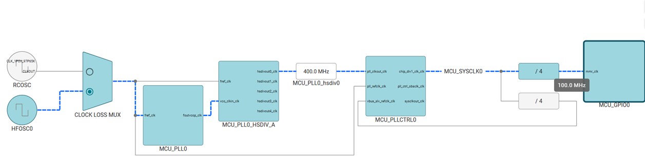

    From section "GPIO Integration" / subsection "GPIO Integration in MCU Domain" / Table "MCU_GPIO0 Clocks" of the AM6442 TRMthe input clock feeding the MCU_GPIO0 has frequency of MCU_SYSCLK0 / 4. According to the SYSCONFIG / AM6x Clock Tree (1.1.4) tool AM6x Clock Tree tool , section Peripherals/General Connectivity/MCU_GPIO0 -> the default MCU_SYSCLK0 frequency is 400 MHz which means that the default MCU_GPIO0 module functional/interface clock frequency is MCU_SYSCLK0 freq / 4 = 400 MHz / 4 = 100 MHz.
    This frequency corresponds to a GPIO func. / interface clock period  P = 10 ns:
    GPIO inputs:
    With 1.8 V GPIO power supply: the minimum pulse width allowed on a MCU GPIO input  is 2P + 2.6 = 22.6 ns and therefore maximum supported GPIO input frequency is:
    MaxGpioInFreq =1 / 2* tw(gpio_in)min = 1 / ( 2 * 22.6 ns ) = 22.12 MHz
    With 3.3V GPIO power supply: the minimum pulse width allowed on a MCU GPIO input  is 2P + 3.5 = 23.5 ns and therefore maximum supported GPIO input frequency is:
    MaxGpioInFreq =1 / 2* tw(gpio_in)min = 1 / ( 2 * 23.5 ns ) = 21.28 MHz
