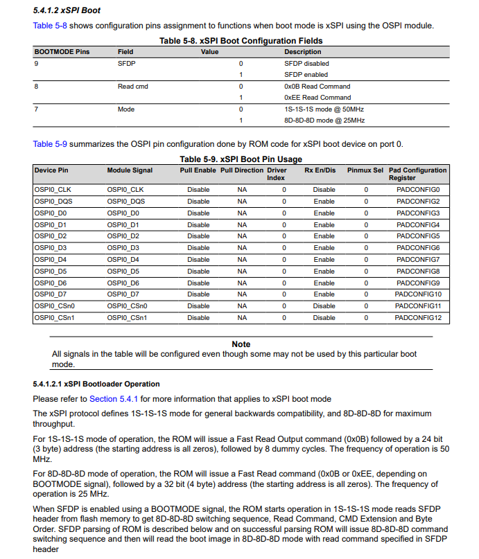

[FAQ] AM62x, AM62Px, AM62D-Q1, AM64x, AM275x: S28HS512T boots in xSPI Bootmode but not in OSPI Bootmode
Part Number: PROCESSOR-SDK-AM62X
The Flash part: S28HS512T is present currently on the following TI EVMs:
  1. https://www.ti.com/tool/TMDS64EVM
  2. https://www.ti.com/tool/TMDS243EVM
  3. https://www.ti.com/tool/SK-AM62B-P1
  4. https://www.ti.com/tool/SK-AM62-SIP
  5. https://www.ti.com/tool/AUDIO-AM62D-EVM
  6. https://www.ti.com/tool/SK-AM64B
  7. https://www.ti.com/tool/TMDS62LEVM
  8. https://www.ti.com/tool/AUDIO-AM275-EVM
It is seen that upon booting in OSPI bootmode, the ROM fails to boot from the mentioned Serial NOR Flash memory.
Let us understand the reasoning behind this.
