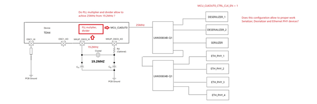

the datasheet specifies that the MUC_CLKOUT0 is meant for Ethernet Phys. if we use this cock as a Deserilizer's ref clock, would it affect the the RGMII communication? below is the clock scheme.

I would not suggest to use the internal clock to be fanned out to be used for Eth PHYs as their clock performance may not meet the required RGMII spec.
I would recommend using an external clock source to communicate with the PHYs.

None of the output clocks of the SoC are intended to be used as a low-jitter reference clock. I would think that there will be communication issues if using them as clock source.

The clock output can be used for the Ethernet PHYs, however, the performance of the clock must be validated by the customer to ensure that it meets their system requirements.
There are too many variables that can impact jitter and hence we do not define the performance of our clocks in the datasheet. One example is the combination of the device reference clock frequency and the PLL configuration required to achieve the desired frequency, where jitter can be significantly different if the PLL is configured to operate in integer mode vs fractional mode, or even different M/N values. Another example is that the PLL power supply noise on the customer's PCB can impact jitter.
These system-level dependencies vary based on the specific implementation. Therefore, we tell customers that they can use the clock output as long as they validate that its performance meets the requirements of the attached device(s).
