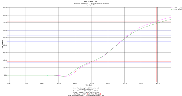

Same trace in the simulation with the IBIS models from the Ti website for the AM62L and the DP83867IRRGZ achieve a time of 760.4 ps, which would be a bit off, but I would happy if I got that.
The software we use is Mentor Hyperlynx.
My question would be now, how come that the simulation is that different from the real world? We tried to tinker with the simulation and only get a matching result, if we insert a 60R series termination. Which is a lot.

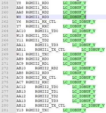

  • We searched for a bit, and did find that in the IBIS model the RGMII interfaces are all labled as IO and not as LVCMOS. We changed it, and got better results, even tho with a lot of reflections.

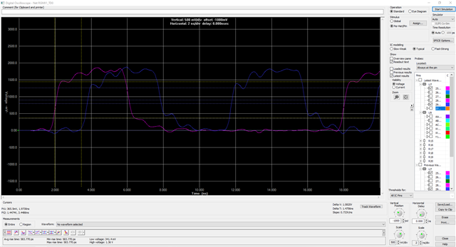

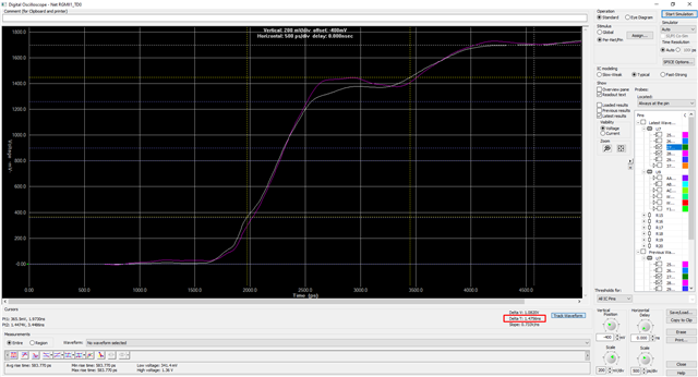

  • This is what it looks like right now.
    The timing is at least somewhere near our measurement, but still a bit off. But remarkable for me is the reflections on that, even tho the ramp is much slower.
    This is the simulation for CLK/RGMII
    And this is the measurement

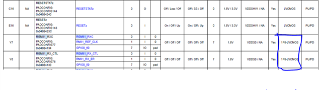

    Of course, I don't want to tinker with the IBIS model. But I hope we are on the same page, that it is kind of strange that when the RGMII is marked as LVCMOS in the datasheet it is not represented in this way in the IBIS model. Which sparks the question if the model is correct.
    So my concerns as TL;DR: SoC/Phy combination doesn't provide the necessary rise/fall time to comply with IEEE, hence making the interface hardly sellable. Simulation is vastly different, causing question about the model.

    Regarding the  buffer type for the RGMII please see the below picture.
    sreenivasa

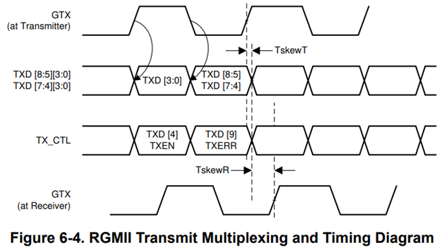

  • Well... I am not on the same page here, to be honest. But maybe I forgot to mention that we are speaking of 1000 Mbps and not 100 Mbps
    So according to your datasheet, the rise fall time is at max 0.75 ns. You surely can add some inaccuracy because of the scope and all, but it should not be that far off.
    And only then you would be able to fulfil some undocumented setup and hold time, which is not even marked in the timing diagram and is solely based on the skew time, which is a sufficient definition, as long as rise/fall time are in spec.
