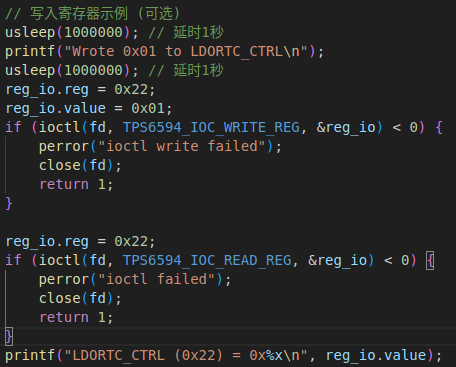

  • I have tried configuring the SOFT_REBOOT_REGIST of PMIC and writing 0x01 into this register to achieve the software reset operation of PMIC.
    But it seems to have no effect. During the discharge process of the supercapacitor, resetting the PMIC, reconnecting VCC for power supply, and SOC also failed to start normally
    So I want to know if there are any other registers that can make PMIC shut down/stop working normally

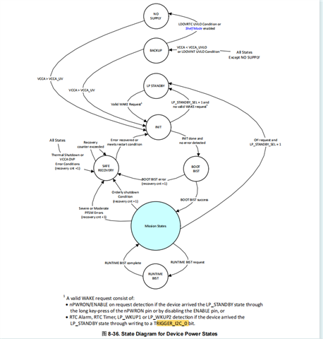

    According to the state machine transition diagram, it can be concluded that:
    We have 4 situations to consider
     1.Under normal circumstances, the process from NO SUPPLY to connecting VCC for power on is as follows:
    NO SUPPLY——>INIT——>BOOT BIST——>Mission States
     2.If VCC is disconnected and EDLC is used as the power supply for VCCA, and this process is never reconnected to VCC
     3.Disconnect VCC, EDLC serves as the power supply for VCCA, and the VCCA voltage is below about 3.2V. At this point, it can be considered as entering an abnormal working state. What needs to be confirmed here/What I want to ask is
    (1) Is PMIC currently in the BACKUP state?
    (2) From the state diagram, it appears that only VCCA<VCCA_UVLO (2.75V) will enter the BACKUP state. Why is it that SOC printing cannot be seen when VCCA<3.2V is actually measured. Is it possible that PMIC is still in a mission state at this time, but the power supply is insufficient to support the normal operation of SOC?
     4.Connect VCC in an undervoltage state, and VCC serves as the power supply for VCCA. At this point, VCCA is definitely greater than VCCA_UV.
    Why didn't you go through the process of NO SUPERY ->INIT ->BOOT BIST ->Mission States in this situation? It is possible to go NO SUPERY ->INIT ->LP STANDBY. Or it's unclear what state PMIC is in at this moment. Because in this situation, it is not possible to read the registers of PMIC. So what needs to be confirmed is/what I want to ask is
    (1) What is the status of PMIC in this situation? Is it in LP STANDBY or any other state?
    (2) What means should I use to confirm the current status of PMIC?
    Explanation: Any_State=All States Except NO SUPERY
    If the content of the data manual is correct (please help confirm if the following parameters are correct):
    The two ways to switch from All States Except NO SUPERY to the BACKUP state are:
    1 VCCA<VCCA_UVLO(2.75V)
    2 LDOVINT UVLO Condition=LDOVINT < 1.64V
    For method 1, if the measured VCCA is less than 3.2V, the printing of SOC cannot be seen; When VCCA<1.6V and VCC is reconnected, the startup print of SOC can be seen.

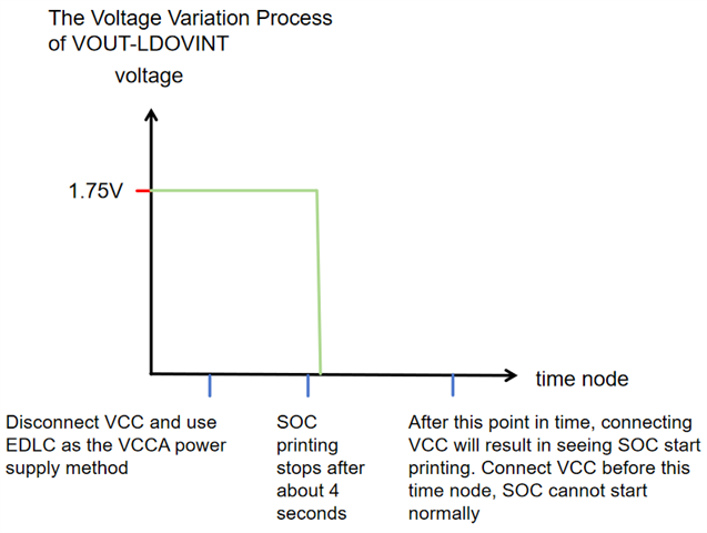

    For method 2, VOUT_LDOVINT measures 1.75V when connected to VCC power supply. After disconnecting VCC from EDLC power supply, the voltage remains at 1.75V. After printing stops for 3-4 seconds, 1.75V will drop directly to 0V. It will take about 8 seconds to see the start printing of SOC when connected to VCC.

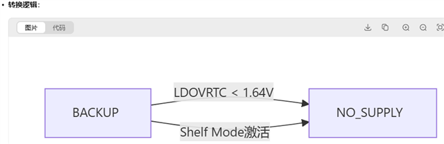

    There are two ways to switch from the BACKUP state to the NO SUPERY state:

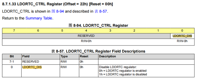

    1 LDOVRTC UVLO Condition=LDOVRTC<1.64V
    2.The condition for Shelf Mode enabled is
    (1) In the mission state, let LDORTC_DIS=1
    (2) Immediately reduce the VCCA voltage to 0V (remove the main power supply)
    For method 1, it appears that reconnecting VCC when LDOVRTC<1.64V does indeed result in SOC startup printing.
    For method 2, I can use SOC to write the PMIC register pin LDORTC_DIS=1 through I2C,
    What I want to ask is: how can I set the voltage of VCCA to 0V? When I disconnect VCC, VCCA will be provided by EDLC, so there is no way to immediately drop to 0V.
