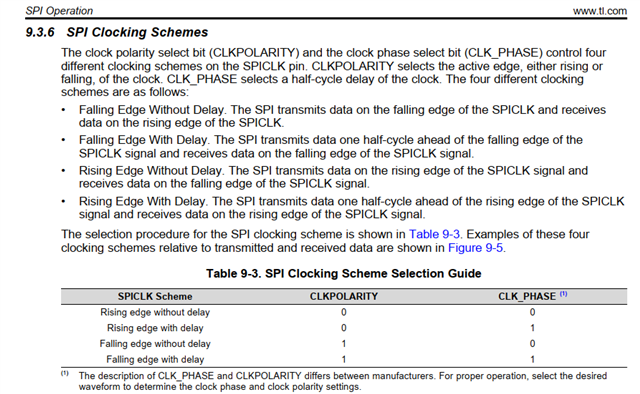

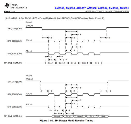

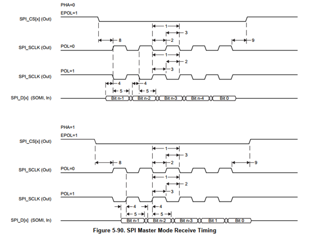

    We are currently debugging SPI communication issues between an ARM (AM335x) and a DSP (TMS320F28335). We noticed that although both platforms have the same physical SPI mode (for example, both are set to CPOL=1, CPHA=0), the numeric definitions and the resulting timing diagrams appear to be different between the ARM and the DSP documentation.
    1. Reference Material
    • On the ARM side (AM335x), SPI Mode 2 is defined as CPOL=1, CPHA=0.
    • On the DSP side (TMS320F28335), the SPI register bits and timing diagrams seem to interpret CPOL/CPHA slightly differently.
    (See attached screenshots below for documentation examples.)
    2. Our Confusion
    Even when we set both devices to the “same” SPI mode (e.g., CPOL=1, CPHA=0), we sometimes observe data misalignment or timing issues. The timing diagrams in the manuals for ARM and DSP for the same CPOL/CPHA settings also look different in terms of clock/data relationship.
    - Why are the numeric definitions of CPOL/CPHA not fully consistent across different TI chips?
    - How should we reliably match the SPI modes between AM335x and TMS320F28335?
    - Is there an official TI recommendation for cross-platform SPI configuration to avoid such confusion?

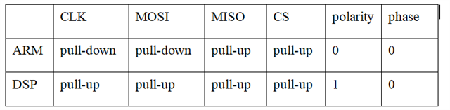

  • Hi TI Experts,
    We are developing an SPI communication link between an AM3352 (ARM, as SPI master) and a TMS320F28335 (DSP, as SPI slave).
    All SPI signal line pull-up and pull-down settings use the internal configuration of each chip only; there are no external resistors on the board.
    1. Current Configuration
    • SPI master: AM3352, slave: F28335
    • Typical SPI speed: 1.5 MHz
    • All pull-up/down: internal only (no external resistors)
    2. Questions
    • Is this pull-up/pull-down configuration correct and robust for ARM master to DSP slave connection?
    • Is there an official or recommended best practice from TI regarding SPI pull-up/pull-down resistor settings for this scenario?
    • Can improper internal pull-up/down settings cause data misalignment or communication problems, especially at power-up?
    • Should any lines (such as unused pins) be configured differently?
    3. Issue
    • With this setup, we occasionally see data misalignment or lost communication after power-on.
    • We want to make sure the pull-up/down settings are correct on both sides.
    Any official guidance or reference schematic would be greatly appreciated.
    Thank you for your support!
    zhou zhou

  • Hi Zhou, I got a clarification from a colleague: we cannot assume that mode 2 in AM335x is the same as mode 2 for TMS320F28335.
    The best way is to review the timing graphics. Please take a look at the table below and ensure that both devices are configured to the same SPI operating mode to ensure stable communication.
    SPI Operating Mode
    AM335x
    F2833x
    SPICLK active high and sampling occurs on the rising edge
    POL=0
    PHA=0
    CLKPOLARITY = 0
    CLK_PHASE = 1
    SPICLK active high and sampling occurs on the falling edge
    POL=0
    PHA=1
    CLKPOLARITY = 0
    CLK_PHASE = 0
    SPICLK active low and sampling occurs on the falling edge
    POL=1
    PHA=0
    CLKPOLARITY = 1
    CLK_PHASE = 1
    SPICLK active low and sampling occurs on the rising edge
    POL=1
    PHA=1
    CLKPOLARITY = 1
    CLK_PHASE = 0
    AM335x SitaraTm Processors datasheet (Rev. L)
    thank you,
    Paula

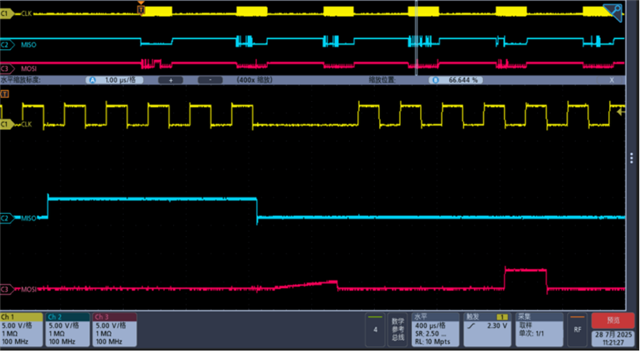

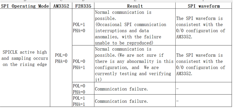

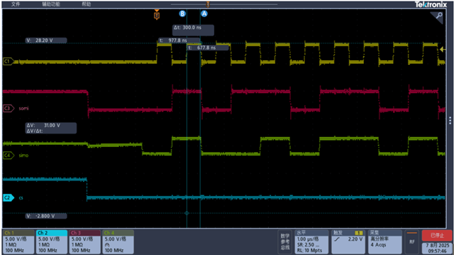

  • hi,Paula,
    Based on your suggestion, we have retested and reorganized as follows:
    The waveforms under F28335 1/0 or 0/1 configurations are shown in the following figure.
    My question are:
    1)According to the SPI clock and phase configuration, why does the waveform of F28335 in the 1/0 configuration match exactly with that in the 0/1 configuration?
    2)Under what circumstances does the F28335 1/0 configuration work abnormally?
    Look forward to your reply.
    Thank you!
    zhou zhou

  • Zhou, let me get inputs from our C2000 expert w.r.t your F28335 questions.
    On the other hand, can confirm below combination is working OK?. In your previous message it says it was still being evaluated, so I would like to know the current status
    SPI Operating Mode
    AM335x
    F2833x
    POL=0
    PHA=0
    CLKPOLARITY = 0
    CLK_PHASE = 1
    thank you,
    Paula
  • HI,Paula,
    When the clock polarity and phase of AM335X are set to 0/0 and the DSP is set to 0/1, there were no issues during laboratory testing. The software will be updated and verified on the train tomorrow.
    Thanks!
    Zhou zhou
