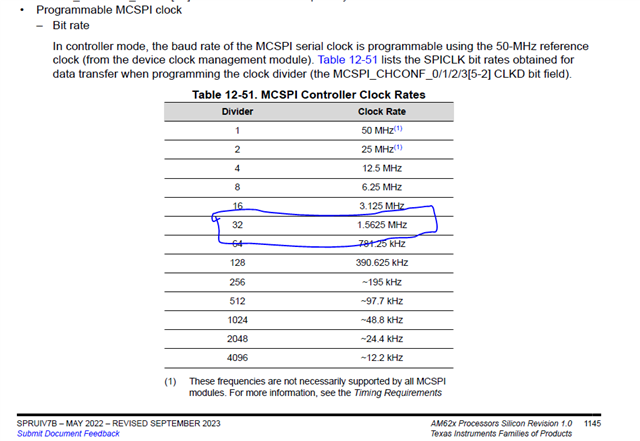

customer needs a special SPI controller clock frequency of 1.4MHz, 1.6MHz and 1.78MHz. I think this is not possible with the MCSPI. Can this be done on the ICSS to emulate a SPI with this clock rates? I saw the TIDA-01555 ref design (https://www.ti.com/tool/TIDA-01555). This is the only SPI example on PRU we did?
