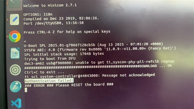

customer board boot from DFU can sometimes download tispl.bin, sometime can't finish tispl.bin downloading.
I think it is DDR problem, customer just copy the DDR layout from EVM board, did not do simulation by themself yet, so use EVM board IO configuration, only changed DDR Density from 16 to 8 as LPDDR4 device is 4GB on custom board. Also modified memory size in dts to 4GB.

  • Tony,
    1. Have they tried to lower DDR frequency?
    2. How many boards have they tried, and do they all show the same issue?
    3. Is the customer able to connect through JTAG to visually inspect the DDR system address space?
    Kevin

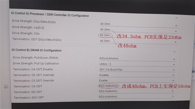

  • Kevin,
    Customer adjust impedance according to simulation result.
    change memory size to 4GB in kernel dts already.
