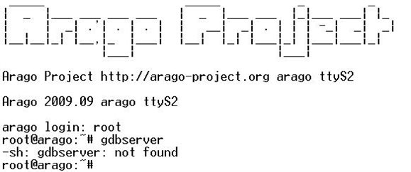

    I  am new to Linux and CCS5. I want to debug my code. I am using OMAPL138 Zoom EVM.I need of GDB server in target.
I am getting " command not found" error, while running gdbserver command in the EVM board. which is given below:
Help me to solve this..
    The default filesystem may not have GDBServer on  it. You will need to copy over GDBServer from your Codesourcery installation. Please copy <codesourcery installation>/arm-none-linux-gnueabi/libc/usr/bin/gdbserver to <targetfs>/usr/bin and copy <codesourcery installation>/arm-none-linux-gnueabi/libc/lib/libthread_db* to <targetfs>/lib
