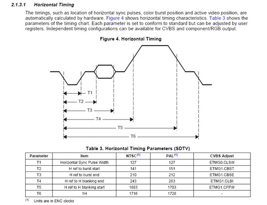

We try to fine tune the SD video encorder NTSC output waveform because it is not good enough.
I can find some register definition, such as, ...
SD_VENC ESTAT,
SD_VENC ECTL,
SD_VENC ETMG0,
SD_VENC ETMG1,
SD_VENC ETMG2,
Unfortunately, I can not find the relation ship between NTSC waveform and these register.
I found an example document from "TMS320DM35x Digital Media System-on-Chip (DMSoC) Video Processing Back End Reference Guide" (SPRUF72C).
This description make us easy to understand the register to NTSC Horizonal Timing relations.
Could you kindly provide the information of where to get the document of DM814x to describe how to fine tune NTSC waveform like this one?

    I upload 4 pictures to explain our issues. Pic_02, 03 and 04 are measured by equipment "Tektronix 1741C".
    Pic_01: Standard 75%NTSC_Color_Bar
    Pic_02: NTSC Composite Video Signal
    Pic_03: Vectorscope Display
    Pic_04: ColorBar
    Support DM8148 is output 75% color bar.
    Our issues are:
    Issue 1). How can we fine tune to meet 100% color bar?
    Issue 2). The SYNC LEVEL should be -40 IRE, but we only measure about -30 IRE.
    Issue 3). In Pic_03, the vectore display seems become two lines in it. The two lines sould be overlay and become one line.

  • OK, first for the vector scope trace... This is currently pretty darned good!!! The 2 lines you see are only telling you that the transition from one color to the next does not occur instantly (which it can't really due to bandwidth limits and filtering of the encoding scheme). You MIGHT be able to improve this slightly by changing the output filter on your PCB to include a little peaking to help the transitions to occur faster, but this then can cause its own issues.
    Regarding the 75%/100% color bar question... I think you are confusing terminology. The term 75% or 100% refers to the source image type you are using in the first place. There are various types of source image used for testing and in reality should be named "75%/75%", 75%/100%", "100%/75%" or "100%/100%" where the first number describes the white level in the image and the second level describes chroma level. To confuse things even further the terms are mixed up when talking about PAL and NTSC testing.
    Bottom line is that for NTSC measurements are usually taken using a 75% reference image in which the white level is at 77 IRE and the chroma excursion is at 100IRE (as you have shown above)
    I think that the Tektronix scope is doing some auto scaling somewhere since the vector scope indicates a slightly low gain but the waveform looks slightly high.
    If you adjust the gain for the vector scope trace you will likely find that the vectors hit the professional grade targets, or get very close to them. Currently you are well within the consumer grade targets.
    Increasing the gain will also increase your sync level closer to 40 IRE, so your 'error' is not actually as high as you might think.
    If you really do want to adjust the sync level then you can adjust register 0x48105e9c. Bits 12:0 set the sync tip level and bits 27:16 set the sync amplitude.
