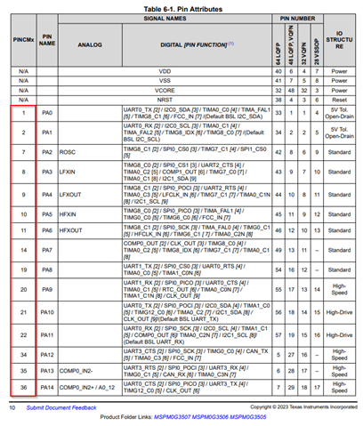

I am using LP-MSPM0G3507 development kit. I have a question about GPIO-IOMUX pin numbers.
For example i wanna use GPIO_PIN_15 and its equal to IO_MUX_PINCM32.
How can i calculate IOMUX number with using PIN number?
Is there an equation I can use?
Or do you have a GPIO PIN and IOMUX equation table or image?
I want to table like this;
PORTB GPIO_PIN_15 => IO_MUX_PINCM32,
PORTA GPIO_PIN_29 => IO_MUX_PINCM59, etc.
