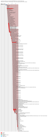

AM62A7: In systemd, how can I make the service I add start up more quickly
Part Number: AM62A7
Hello, TI team
I added a "hd260_init.service" in systemd to start my application to display the camera images.
However, the hd260_init.service is almost the last one to start.
I would like to know how to start this service more quickly.
The following is the detailed content of hd260_init.service and its startup sequence.
/etc/systemd/system/hd260_init.service
[Unit]
Description=BootStart Script Service
[Service]
Type=forking
ExecStart=/root/bootstart.sh
Restart=on-failure
User=root
WorkingDirectory=/root
StandardOutput=tty
TTYPath=/dev/ttyS2
[Install]
WantedBy=sysinit.target
root@am62axx-evm:~# systemd-analyze
Startup finished in 1.232s (kernel) + 3.586s (userspace) = 4.818s
multi-user.target reached after 3.520s in userspace.
root@am62axx-evm:~#
