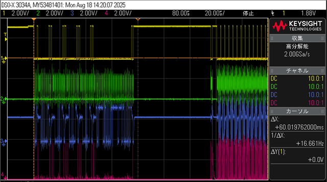

However, when observing the QSPI (CS, CLK, SO, SI) with an oscilloscope,
it appears that some communication is taking place, and it seems to be reading the image from the Flash.
When comparing the QSPI waveforms from a successful Flash Boot using the TMDS273EVM
and the waveforms from a failed Flash Boot on our own board, they appear to be the same.

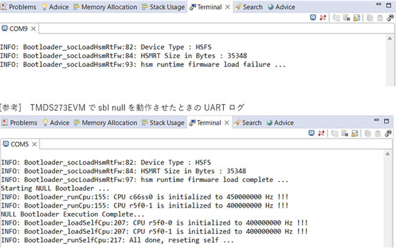

    As an additional verification, I performed SOC initialisation using the sbl_null sample.
    When I ran QSPI boot, I obtained the following UART log.
    It seems that the Hsm runtime firmware failed to load.
    Is it necessary to write the Hsm runtime firmware using uniflash or similar to perform QSPI boot?
    Ito

  • Hi Ito-san,
    The HSM RT image in the mcu_plus_sdk_am273x_09_02_00_52\source\drivers\hsmclient\soc\am273x\hsmRtImg.h needs to be updated. Here is the new HSM RT image:
    tifs_am273x_hs_fs.release.hsmimage_pg1.2_signed.bin
    You will need to convert it into the array HSMRT_IMG and replace the one in the hsmRtImg.h.
    You will also need to re-build the libraries by calling the following:
    gamke -f makefile.am273x libs
    AND
    re-build your SBL_QSPI too.
    Ming
