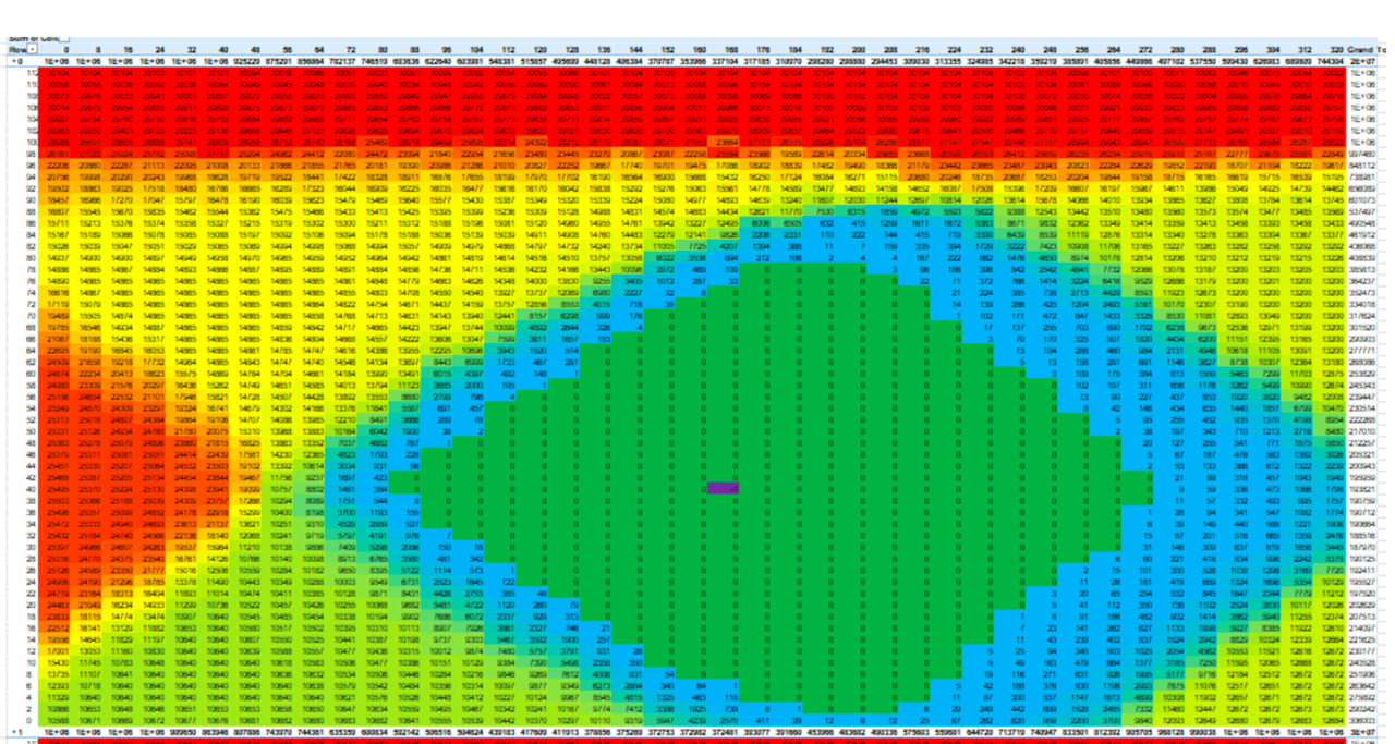

Could you please explain the details of the plot below: (a) what do vertical and horizontal axis mean? (b) what is the color coding criteria? (c) how the numerical ratings are obtained? Any other comments? -- thank you!

Gentle FYI, this plot is from a version of the tool for Jacinto devices. The version that supports AM62P is here: https://www.ti.com/tool/download/DDR-MARGIN-FW/
That being said, they both function essentially the same, though the output itself differs slightly on if this picture is from a read eye vs a write eye:
1) Each vertical tick is a different DQ VREF setting in either the DDR IP or DRAM and these settings can be roughly translated into a % of VDDQ. Each horizontal tick is a different delay setting relating to a percent of a clock cycle.
2) It's color coded by failure rate, which is the number in each box. Green-> Red in terms of increasing failure rate.
3) The numbers are obtained through on silicon measurements. This excel report is generated from a script, which takes in output from a piece of firmware running on silicon. The firmware will test various combinations of VREF and delay and then report how much failing data was seen at each combination tested.
