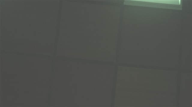

We are evaluating using an im219 sensor with AM62SIP and are trying to get a standard format video stream (standard as in MJPEG, etc).
The issue is, of course, that the AM62SIP does not have a hardware ISP like the AM62A does.
So has anyone been able to get a standard format video stream out of the AM62SIP board with IMX219 sensor?
We are currently looking into 3 approaches:
1. use libcamera as ISP
2. use Infinite ISP as ISP
3. use Opencv as ISP
We are able to capture, save, and display a single bayer image from the imx219 by using a crude GStreamer ISP Bayer2RGB with the following commands
Take and save image:
media-ctl --set-v4l2 '"imx219 1-0010":0[fmt:SRGGB8/1920x1080]' ; media-ctl -d 0 --set-v4l2 ''\''cdns_csi2rx.30101000.csi-bridge'\'':0 [fmt:SRGGB8/1920x1080]'; media-ctl -d 0 --set-v4l2 ''\''30102000.ticsi2rx'\'':0 [fmt:SRGGB8/1920x1080]'
gst-launch-1.0 v4l2src device="/dev/video0" num-buffers=1 ! video/x-bayer, format=rggb, width=1920, height=1080 ! bayer2rgb ! jpegenc ! filesink location=image.jpg
Take image and display over HDMI:
systemctl stop weston
gst-launch-1.0 v4l2src device="/dev/video0" num-buffers=1 ! video/x-bayer, format=rggb, width=1920, height=1080 ! bayer2rgb ! imagefreeze ! kmssink driver-name=tidss plane-properties=s,zpos=1
The issue is that the crude bayer2rgb conversion from GStreamer shows images that are green and low quality.
This is why we are exploring alternatives.

Here is an example image:
Any and all help will be very appreciated!
  • Hi all,
    We have a solution for those who have this issue in the future.
    We used OpenCV to do the software ISP and configured media-ctl + v4l2-ctl to dial gains and configure image format.
    Below, we will provide manual instructions for setting up ISP for imx219 and an SD image that is preconfigured.
    Still, if anyone sees this and knows of a more efficient / better ISP software solution for this board, please reply below.

    SD image:
    (Link will be updated later today)
    root dir contains:
    ISP_pipeline.py  __pycache__  faster_flask.py  setup_imx219.sh  venv
    IPS_pipeline.py is the OpenCV ISP implementation. Runs 480p at 30fps with adequate white balancing.
    faster_flask.py contains a Flask server that hosts video for connected Linux-based laptops (Tested on Ubuntu 22.04, MacOS, and ChromeOS)
    setup_imx219.sh contains setup scripts for media-ctl and v4l2-ctl
    How to use the provided SD image.
    Connect power to AM62SIP, then connect the DRP USB-C port to Linux based laptop.
    30 seconds after the AM62SIP board boots, a new Ethernet connection will connect on the laptop
    On the laptop, open Google Chrome and go to 192.168.7.1:8080
    The video stream will begin
    If the video stream does not start >1 minute after AM625 boot, refresh the Chrome page.
    Pipeline description and documentation:
    End-to-End CSI Camera → On-Device ISP → MJPEG over HTTP
    This document describes the complete data path and configuration used to stream frames from the IMX219 CSI camera to a web endpoint for display. It covers:

    B_GAIN, G_GAIN, R_GAIN = 1.40, 1.00, 1.40
    SAT, GAMMA = 1.40, 1.20
    Processing per frame:
    1. Demosaic: cv2.cvtColor(bayer8, cv2.COLOR_BayerBG2BGR)
      • Converts raw mosaiced Bayer8 to 3-channel BGR.
      • The constant COLOR_BayerBG2BGR selects the BGGR layout used by this pipeline.
    2. White balance (WB): channel-wise LUTs (cv2.LUT)
      • Three precomputed 8-bit LUTs scale each channel to adjust color temperature neutrally and cheaply.
    3. Saturation: HSV domain scaling
      • Convert BGR→HSV, scale S, convert back to BGR. Provides predictable saturation control.
    4. Gamma: one 8-bit LUT
      • Approximates an sRGB-like transfer function to lift shadows and compress highlights.
    Each step’s timing is accumulated and reported periodically for monitoring.
