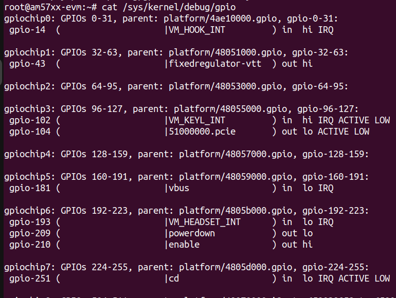

I am facing an issue with headphone detection on AM5728 using TI SDK 9.03. The same hardware worked in SDK 6.03, where evtest correctly showed KEY_DOWN / KEY_UP events on plug/unplug.

Additional observation:
  • According to GPIO calculation, gpio5_1 (DTS, GPIO 129) should appear under gpiochip4, as it did in SDK 6.03.
  • In SDK 9.03, however, it shows under gpiochip6 (GPIO 193).
  • This mismatch may be affecting the gpio-keys binding and preventing evtest from detecting events.
If you need any additional information, please let me know.
