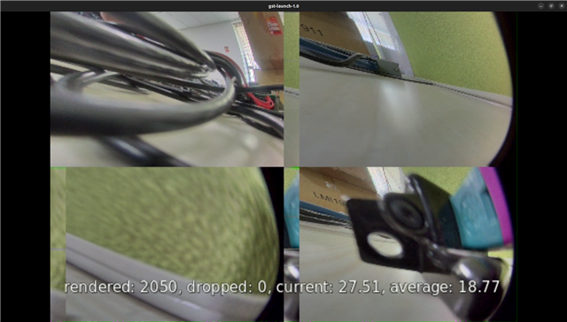

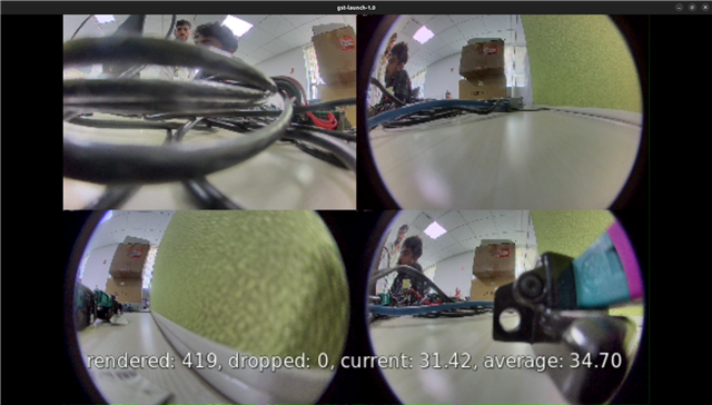

We are using a TDA4VM-based custom board with a multicamera application (Producer-consumer). When modifying our pipeline to reduce the resolution via subsampling, we’re observing an issue where lens ring artifacts appear in camera channels 2, 3, and 4 during live quad view. Single view works fine for all the cameras.
Pipeline Details:
Initial (working) pipeline:

Issue Observed:
  • With the modified pipeline, lens ring artifacts appear in the output of camera channels 2, 3, and 4.
  • Camera 1 seems unaffected.
  • We suspect this may be related to using an LDC LUT generated for 1920x1080 input, while the new resolution is 960x608.
