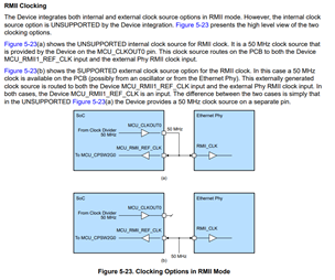

I have a question about the RMII clock configuration on P379 of the TRM.
The RMII clock configuration consists of Figure 5-23(a) and (b), but the document states that (a) configuration is not supported.
I want to configure (a), is it really not supported?

  • Bhavpreeta,
    Sorry for the delayed response during my OoO.
    Yes, the internal ref clk option is unsupported. The reason is that the RMII spec requires the clock to be within a certain ppm for successful operation; we cannot guarantee that the clock sharing to the external PHY over the PCB/ traces can still meet the ppm requirement required for the RMII operation.
    You could certainly validate if it fits your system use case and implement if found satisfactory.
