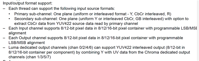

TDA4AL-Q1: Feeding Raw bayer to Multiscalar
Part Number: TDA4AL-Q1
HI,
We have requirement to resize raw bayer image(RCCG) to dowsized resolutions and extract Red channel from it. is it possible to achieve the same using MSC. We got Below documentation from techincal reference manual, where TI mentioned R and GB in primary and secondary subchannel. However, we are not clear on the info.could you help using in fulfilling this requirement?
