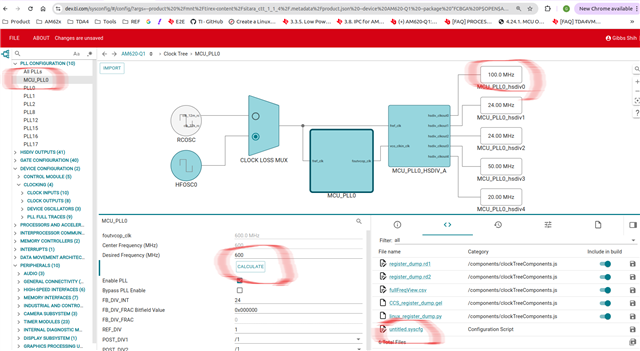

    I try to use clock tree to configure M4F clock, setting as below.
    * untitled.syscfg
     * Write custom configuration values to the imported modules.
    const PLL1                  = system.clockTree["MCU_pllfracf2_ssmod_16fft0"];
    PLL1.FB_DIV_INT_DivideValue = 24;
    REGISTER SETTING
    May I know how to modify (change) this setting in u-boot or linux code?

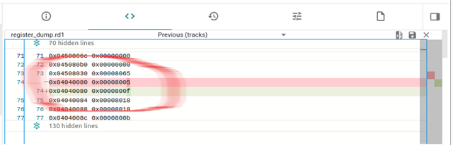

    (2) Change HSDIV setting from 6 to 16 in clock tree, and generate register setting sets.
    (3) Direct register setting
    root@am62xx-lp-evm:~# devmem2 0x04040080
    /dev/mem opened.
    Memory mapped at address 0xffffb577d000.
    Read at address  0x04040080 (0xffffb577d080): 0x00008005
    root@am62xx-lp-evm:~# devmem2 0x04040080 w 0x0000801f
    /dev/mem opened.
    Memory mapped at address 0xffff9291b000.
    Read at address  0x04040080 (0xffff9291b080): 0x00008005
    Write at address 0x04040080 (0xffff9291b080): 0x0000801F, readback 0x0000801F
    /dev/mem opened.
    Memory mapped at address 0xffff9f20a000.
    Read at address  0x04040080 (0xffff9f20a080): 0x0000801F
    (4) Check MCU_M4FSS0* clock again, it seems take effort
    root@am62xx-lp-evm:~# k3conf dump clocks | grep EV_MCU_M4FSS0
    |     8     |     0    | DEV_MCU_M4FSS0_CBASS_0_CLK                                                                           | CLK_STATE_READY     | 75000000        |
    |     9     |     0    | DEV_MCU_M4FSS0_CORE0_DAP_CLK                                                                         | CLK_STATE_READY     | 75000000        |
    |     9     |     1    | DEV_MCU_M4FSS0_CORE0_VBUS_CLK                                                                        | CLK_STATE_READY     | 150000000       |
    |     9     |     2    | DEV_MCU_M4FSS0_CORE0_VBUS_CLK_PARENT_SAM62_PLL_CTRL_WRAP_MCU_0_CHIP_DIV1_CLK_CLK                     | CLK_STATE_READY     | 150000000       |
    |     9     |     3    | DEV_MCU_M4FSS0_CORE0_VBUS_CLK_PARENT_SAM62_PLL_CTRL_WRAP_MCU_0_CHIP_DIV1_CLK_CLK2                    | CLK_STATE_READY     | 75000000        |
    Question : How do I make sure it real take effort to reduce operation clock for M4SS ?

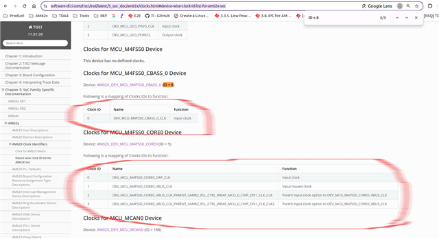

    Case 2 , steps as below :
    (1) Reference device ID & clock ID as below.
    https://software-dl.ti.com/tisci/esd/latest/5_soc_doc/am62x/clocks.html#device-wise-clock-id-list-for-am62x-soc
    (2) Modify device tree.
    k3-am62-mcu.dtsi
    device id set 9, clock id set <9 1>, partent id set <9 2>
    	mcu_m4fss: m4fss@5000000 {
    		compatible = "ti,am64-m4fss";
    		reg = <0x00 0x5000000 0x00 0x30000>,
    		      <0x00 0x5040000 0x00 0x10000>;
    		reg-names = "iram", "dram";
    		resets = <&k3_reset 9 1>;
    		/* Gibbs@202050828 */
    		clocks = <&k3_clks 9 1>;
    		assigned-clocks = <&k3_clks 9 1>;
    		assigned-clock-parents = <&k3_clks 9 2>;
    		assigned-clock-rates = <200000>;
    		firmware-name = "am62-mcu-m4f0_0-fw";
    		ti,sci = <&dmsc>;
    		ti,sci-dev-id = <9>;
    		ti,sci-proc-ids = <0x18 0xff>;
    		status = "disabled";
    Question :
    1. Does the DTS modification correct?
    2. I feel very confuse, How to map these parameter as below to TRM (register) ? because I can not search right information.
    * DEV_MCU_M4FSS0_CBASS_0_CLK
    * DEV_MCU_M4FSS0_CORE0_DAP_CLK
    * DEV_MCU_M4FSS0_CORE0_VBUS_CLK
    * DEV_MCU_M4FSS0_CORE0_VBUS_CLK_PARENT_SAM62_PLL_CTRL_WRAP_MCU_0_CHIP_DIV1_CLK_CLK
    * DEV_MCU_M4FSS0_CORE0_VBUS_CLK_PARENT_SAM62_PLL_CTRL_WRAP_MCU_0_CHIP_DIV1_CLK_CLK2
    3. Does it mean only success change in Linux MCU DTS, and then it will appear in "kernel clk_summary" result?
    Thank You Very Much

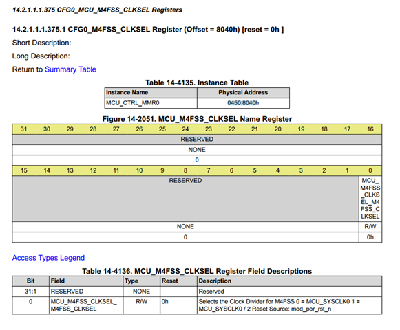

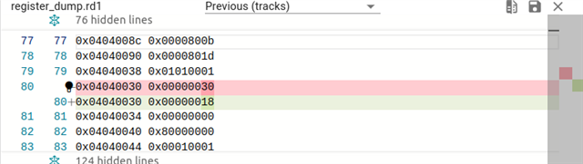

    Wait your replies, and update some conslusions & question what I found in recent days, because my customer also tracking(+learning from) this thread.
    * How to map CLOCK TREE and k3config dump result for M4F core?
    |     8     |     0    | DEV_MCU_M4FSS0_CBASS_0_CLK                                                                           | CLK_STATE_READY     | 200000000       |
    |     9     |     0    | DEV_MCU_M4FSS0_CORE0_DAP_CLK                                                                         | CLK_STATE_READY     | 200000000       |
    |     9     |     1    | DEV_MCU_M4FSS0_CORE0_VBUS_CLK                                                                        | CLK_STATE_READY     | 400000000       |
    |     9     |     2    | DEV_MCU_M4FSS0_CORE0_VBUS_CLK_PARENT_SAM62_PLL_CTRL_WRAP_MCU_0_CHIP_DIV1_CLK_CLK                     | CLK_STATE_READY     | 400000000       |
    |     9     |     3    | DEV_MCU_M4FSS0_CORE0_VBUS_CLK_PARENT_SAM62_PLL_CTRL_WRAP_MCU_0_CHIP_DIV1_CLK_CLK2                    | CLK_STATE_READY     | 200000000       |
    (1) DEV_MCU_M4FSS0_CBASS_0_CLK, Ref.
    (2) DEV_MCU_M4FSS0_CORE0_VBUS_CLK, Ref
    (3) DEV_MCU_M4FSS0_CORE0_VBUS_CLK_PARENT_SAM62_PLL_CTRL_WRAP_MCU_0_CHIP_DIV1_CLK_CLK (400MHz)
    (4) DEV_MCU_M4FSS0_CORE0_VBUS_CLK_PARENT_SAM62_PLL_CTRL_WRAP_MCU_0_CHIP_DIV1_CLK_CLK (200MHz)
    so "MCU_M4SS_CLKSEL" is in register "0x0450 8040" bit 0 for selection.
    Because "k3conf" only dump these clock setting, so I think we can "only change" "DEV_MCU_M4FSS0_CORE0_VBUS_CLK_PARENT_SAM62_PLL_CTRL_WRAP_MCU_0_CHIP_DIV1_CLK_CLK " or "DEV_MCU_M4FSS0_CORE0_VBUS_CLK_PARENT_SAM62_PLL_CTRL_WRAP_MCU_0_CHIP_DIV2_CLK_CLK" for MCU_M4SS0_CORE VBUS_CLOCK setting. So the VBUS_CLOCK should be only for 200MHz or 400MHz.
    If you want to modify another clock rate, you must manual modify "hsdiv_clockout0" by setting MCU_PLL0_HSDIV_A (0x04040080)
    But I think it should be have some side effect, because you may also change DM R5 Clock setting ... etc

    * Is it possible to direct modify register setting for remoteproc drivers (ti_k3_m4_remoteproc.c)?
    I not sure this is an good idea, May we use "roremap()" to direct "hard code" setting register w/o Linux DTS?
    Any sample code?
    Need you suggestion?
    Thank You Very Much
    GIbbs

    I studied & tested few days, so far no update in my side.
    My progress,
    I try to reduce MCU_PLL0_HSDIV0 clock, and restart MCU firmware, I found it caused firmware crash.
    Do you have any new update?
    Thank You Very Much
    Gibbs

    Are we looking at the right clocks?
    Yes.
    https://software-dl.ti.com/tisci/esd/latest/5_soc_doc/am62x/clocks.html#device-wise-clock-id-list-for-am62x-soc only lists 2 input clocks, the DAP clock and the VBUS clock. The DAP clock is just for debug and trace. So we should be looking at the VBUS_CLK input.
    I expect that the 2 input clocks are from the MCU_SYSCLK0 input to MCU_M4FSS_CLKSEL. So they should allow us to select between frequency MCU_PLL0_HSDIV_A_clkout0 (400MHz by default), and MCU_PLL0_HSDIV_A_clkout0/2.
    Double-checking, is 200MHz ok with the customer at this point?
    If so, that (should be) pretty easy for us to select the other input to MCU_M4FSS_CLKSEL.
