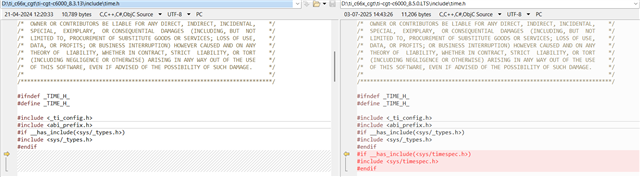

    I was able to idenify the root cause (see, the attached screenshot)
    In CGT v8.5, the runtime library’s <time.h> header introduces an additional include chain:
    • <time.h> now includes <sys/timespec.h>,
    • which in turn includes <sys/_timespec.h>.
    Through this chain, both struct itimerspec and struct timespec are defined by the compiler’s standard headers. This creates a conflict with the TI-RTOS POSIX layer (ti/posix/ccs/time.h), which also declares the same structures, leading to the redefinition errors.
    In earlier CGT versions (e.g., v8.3), <time.h> did not include <sys/timespec.h>, so timespec and itimerspec were not pulled in from the runtime library. As a result, only the TI-RTOS POSIX header provided those definitions, and no conflict occurred.
    To avoid this (If you want to use CGT v8.5) ,
    When working with BIOS/TI-RTOS, include "#include <ti/posix/ccs/time.h>" to ensure you are using the POSIX layer.
    If you only require the compiler’s standard runtime support, include "#include <time.h>" to rely on the CGT runtime library.

  • Hi Valentin,
    Unfortunately, this error appears before the compiler starts with my own code. Error appears when it compiles BIOS itself. In my example -bios_6_83_00_18/packages/ti/posix/tirtos/clock.c
    This actually points to a toolchain vs. BIOS header clash only. (See the attached screenshot above (CGT v8.5))
    (as you have confirmed its working fine with CGT v8.3)

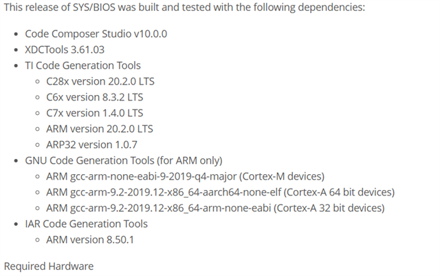

  • Hi Valentin,
    Yes, Exactly. According to the release notes, BIOS 6.83.00.18 was validated with C66x CGT 8.3.2 LTS, so it is recommended to use that specific compiler version for best compatibility.
