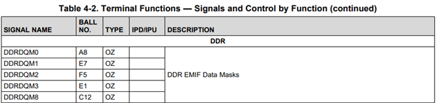

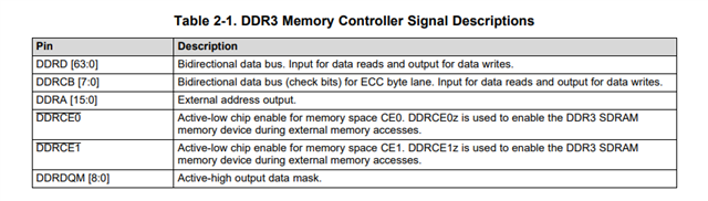

I am wondering if the data masking on the C6655 processor can be disabled?  I went through the datasheets and I can't find any mention of whether the DDR3 data masking can be disabled or if that capability of disabling is even supported.  I have a client that needs the Data Mask feature disabled due to the requirements of the DDR3 chip the processor is connected to.  Does there even need to be any register that gets updated to disable the Data Masking or just terminating the pin good enough?  If we just need to terminate the pin, what are the guidelines for that?
