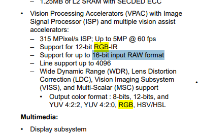

Hi Dilna,
Thank you for your reply.
I understand that AM62A only supports 16-bit RAW input,
so it is designed for Bayer arrays (RGGB/GRBG/GBRG/BGGR)
and does not include RGB-W or the proprietary extended format REB-L.
Kanae
